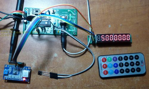

The wiring of the AD9850 module is important to set it into serial mode:
VCC pins 1,18,19,20
GND pins 6,11,17
For my program I'm using pins for the AD9850 as follows:
MM2 pin 16 to pin 4 (Data)
MM2 pin 9 to pin 3 (Latch)
MM2 pin 26 to pin 2 (Clock)
output to scope pin 10
I'm bit banging the output to the AD9850 as neither the MAX7219 or AD9850 have a proper chip select. Both just use a short latch pulse to load the data and it seemed wrong to send both all the clock and data pulses and hope they discard the correct ones.

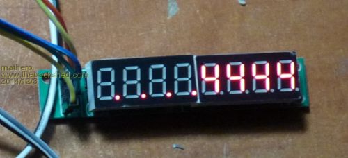

Wait Input mode
Program mode
