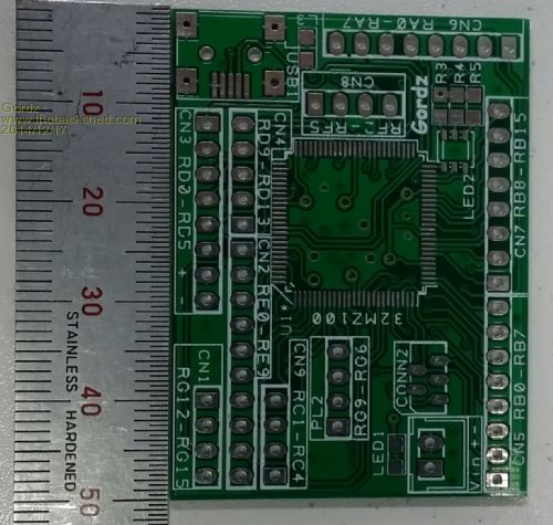

I have just made up a *small simple two layer board for evaluating this chip. If it tests out OK I am happy to release the gerber files for it.

Hi Gordz,
It looks pretty compact..
Heaps of I/O Pins..
Good work,
Gordz
Joined: 10/08/2013
Posts: 55
Posted: 12:37pm 17 Dec 2014
Cheers mate. It's bare bones really but I want to see how quick these chips really are, so there are a bunch of I/O that I could not route / was not worth the bother.
Posted: 12:41pm 17 Dec 2014
The pin-spacing on the QFP looks like fun.
What is that?
0.4mm?
Gordz
Joined: 10/08/2013
Posts: 55
Posted: 12:52pm 17 Dec 2014
yes it's 0.4 mm. The pack is the 12x12mm 100 pin. The board you see has the 14mm chip but of course I have 12mm !! Are you the "Mite" man ?

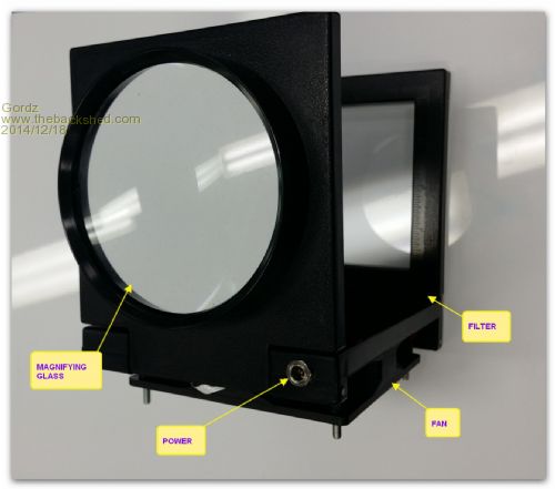

Hand solder. I got some simple stuff from Jaycar and made up a cheap and cheerful SMD station. Should have done it years ago as it works surprisingly well.

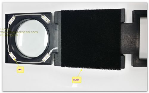

Here it is "laid" out. The fan and filter is also from them. Its way cheaper than a stereo microscope and a fume fan and light
Posted: 03:26pm 17 Dec 2014
That's clever, and less bulky then a lamp & fume extractor arrangement. Awesome. Where did you get the magnifying glass from? I can't find that one on Jaycar's site.

Posted: 03:29pm 17 Dec 2014
Look here
http://www.jaycar.com.au/productView.asp?ID=QM3505&CATID=74& form=CAT2&SUBCATID=956#1
But watch out !! it'll set you back 9 bucks :)
Posted: 03:54pm 17 Dec 2014
Excellent - thanks for the link and idea - I think I am going to have to steal that one for my own workbench.
