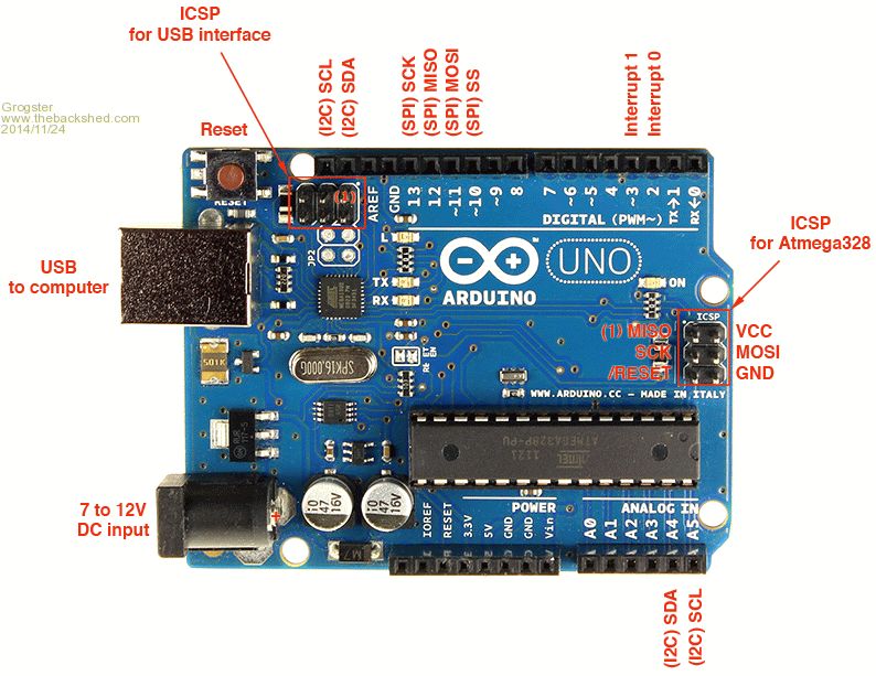

This is the first pinout I found:

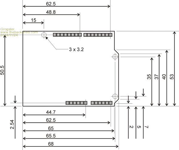

...and these are the dimensions I have found:

Grogster,
Those sizes CANNOT be correct.. the difference between the 62.5 and 48.8 is 13.7mm which is 0.54" given the RH connector is 0.7" long it cannot be.. I have the dimensions around somewhere I will try to dig them out for you.

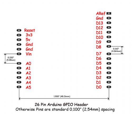

Grogster,
Here are the correct dimensions for the Arduino connector.. Note that there is also an `incorrect' version that has the RHS gap as 0.15".. Whilst this is not quite the original spec they are close enough that they will work.. If you were going to do an Arduino style board I would use the correct 0.16" gap.

I see the distance between the rows is also different in your picture They have it as 50.5-2.54 or 47.96mm whereas it should be 1.9" or 48.26mm
