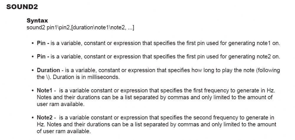

Good 1 I recently came accross via AtomMicroBasicEdited by hitsware 2014-11-25
