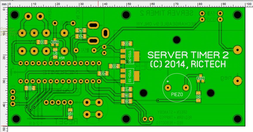

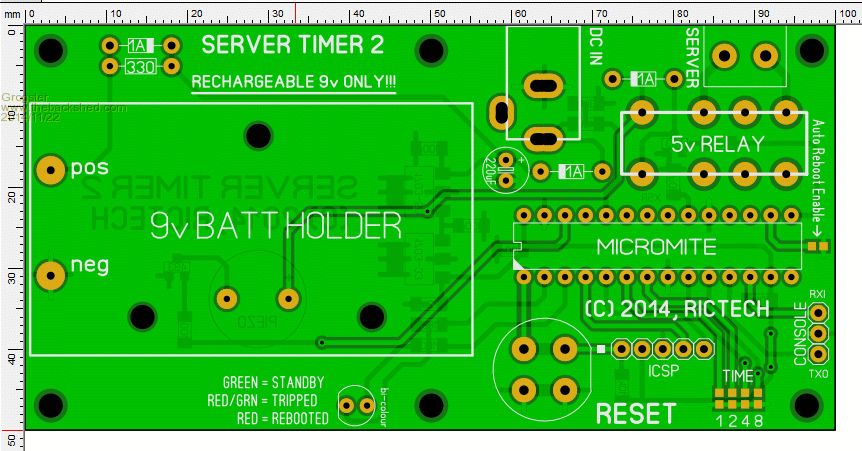

TOP LAYER:
BOTTOM LAYER:
This board is already produced, so there is no design-by-committee issues with this one!!!!!

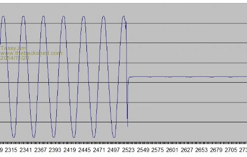

Many years ago (everything seems to have happened many years ago), I worked in the power industry and we have some wonderful old instruments. One I liked was a disturbance recorder. Whenever it was triggered, it would spit out a couple of metres of paper with a chart of the voltages and currents for a few seconds before the event and a few seconds after.
Last week I was sitting at the 'puta when there was a power 'disturbance'. I missed the pretty charts so micromite to the rescue.
The idea is to have one micromite continually reading the voltage and when triggered, spit the 5000 readings out to be analyzed.
A MX150 micromite can take 30 readings per 50Hz cycle and a maximum of 5000 readings.
That gives around 3 seconds.
If you trigger it 2 seconds after the 'event', you will end up with 1 second of pre-event and 2 seconds of post-event.
A MX170 can read a bit faster and store more samples.

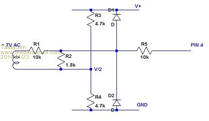

I will end up triggering from a second micromite similar to Grogster's setup.
If you aren't interested in looking at the AC waveform, use a rectifier and a small filter capacitor then slow the reading rate down.
For the AC input I found an old plug-pack with AC out.
The chart is a portion of a test drawn in Excel.

There is no time for the micromite to do any calculations during capture but I am impressed with the quality of the waveform in Excel.
Now I have to wait for a real life 'disturbance' to capture.

Hi Grogster, VERY nice unit!!! Could you post your schematic for this one? Board looks nice too!!!
Posted: 12:20am 23 Jan 2015
Flick me a PM if you are interested, Jim. I can email you the schematic if you like. I also have spare PCB's if you would like one to build your own unit. US$5 + postage.
