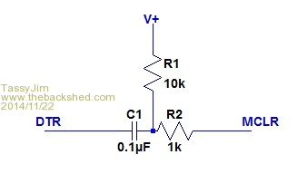

With the number of users pushing micromites and CFUNCTIONS to the limit (and beyond), I have added the ability to pulse the DTR and RTS lines. They send a 100mS pulse which can be used to force a reset. This requires a USB-TTL converter with the handshake lines available.

I always put a 0.1uF in series between DTR and MCLR just to make sure that the 10K to VCC on the PIC doesn't damage the DTR output from the USB<->Serial converter

I intend add a resistor in series with the reset line to protect against the high voltage swing when the DTR line goes high again.
The values chosen seem about right but I will have to check...

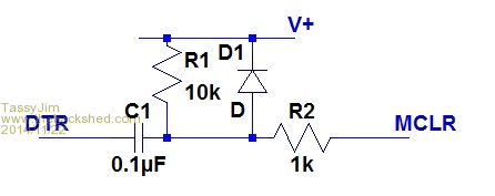

I have added a diode to clamp the positive swings.
With the pickit3 connected directly to the MCLR pin, programming is not affected with the extra components in circuit. I did however, disconnect the DTR line during programming.
