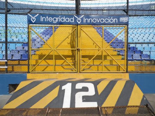

This email was sent to me by Raul Herrera in Guatemala and I am reproducing it here (with Raul's permission) for everyone's interest.
It just shows what you can do with a little computer and BASIC...
I live in Guatemala http://en.wikipedia.org/wiki/Guatemala, and I am an engineer, not in electronics but information systems, electronics its a hobby, this year the sports ministry, call for a solution for the october 16 disaster http://en.wikipedia.org/wiki/Estadio_Mateo_Flores, the stadium was closed for the incident during 15 years, and now, that is remodalated, and certified to hold 30000 people, the security doors, and all the security have to be made from scratch.

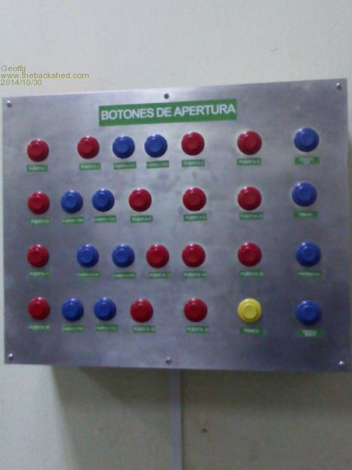

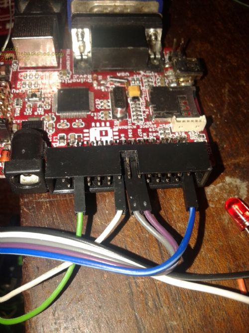

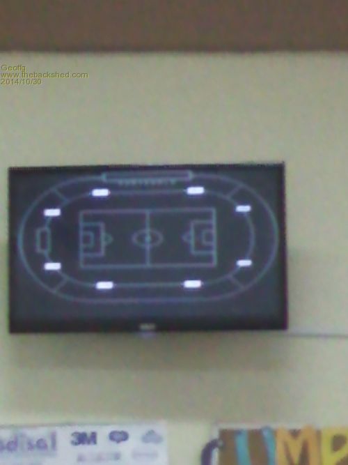

I took and Duinomite mini and develop all the comunication for the whole stadium, that means, a central control unit, that with the push of a button opens or closes any door, with a monitor to display the state of all door, 3km of cable UTP was necesary, max 485 and a ring of communications.
sorry for the bad photos,( if you are interested can send you the final document with HD)

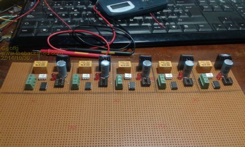

We have to run fast with the modules in each door, I choose Microhip PIC 12f683 that comunicates the state of each door and chance the state of the lock, use a duty for querie the state each 1.2 seconds,
I have to use perforated PCB cause the humidity and the heat caused trouble with the original 7805, I have to put heat discipation and build all the 8 modules from the night to the day.

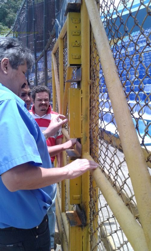

This is a close up for the magenic locks
Those are the doors to the field, before
And this is the location of the stadium, by the way is the biggest in central america
