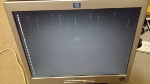

Hi All,
On the way home from work last night I dropped in to Altronics and purchased a Colour Maximite kit.
I had been interested in one for ages, but only just got around to getting one.
Anyway, I put it together last night without any issues (I consider myself competent with a soldering iron, built many things over the years).

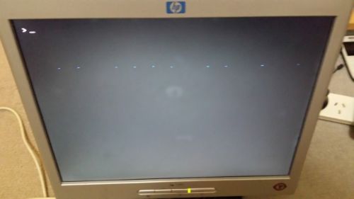

When I first fired it up I immediately noticed a line of blue dots running horizontally through the bootup message.
after performing a clear screen (CLS) the dots were still present and obviously more visible with the boot message gone.
If I then press ennter so that I get to the bottom of the screen, and the screen starts to scroll up...the line of dots also scroll to the top.
Hard to explain so better with a few screenshots.
ALso, to note. This only happens in mode 3.
If I go to mode 1, 2, 4. and type cls the dots go.
If I go into the Editor (Edit) the dots go.
But in mode 3 they are always there...
I have tried the Maximite on three different monitors (different brands) and the dots are present on all of them
The Maximite (PIC) shipped with Basic 4.4B and I upgraded to 4.5
Everything else appears to work OK, files run & save to SD, etc.
Got me stumped, any thoughts would be appreciated.
Cheers,
Shane
*Sorry for the poor quality, the actual colours on the screen are vibrant.
But I think you at least can see what I'm talking about.
Posted: 02:03pm 24 Oct 2014
Yes, that is very interesting. I have no idea why that should be, especially if that artefact goes away when you change out of mode 3 - odd.
Having tried different monitors, you have ruled out a monitor-specific issue, so the problem must indeed be with the CMM - strange.
Please keep us posted, if you have any luck fixing it yourself, and I will be watching this thread with interest to see what happens.
EDIT: I assume that when you tried different monitors, you used different VGA leads too? If not, try a different VGA cable - it could be faulty in some way. It's a long-shot, but VGA cables can do funny things sometimes...Edited by Grogster 2014-10-26

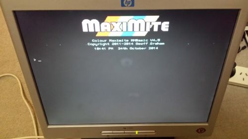

Why are there only three colors in the graphic logo?
Elvish name: Mablung Miriel
Beyound Arduino Lang
Posts: 6631
Posted: 06:27pm 24 Oct 2014
  vasi said   Why are there only three colors in the graphic logo?
Well spotted.
Check the soldering from the CPU to the VGA connector and associated components.

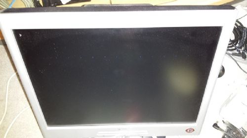

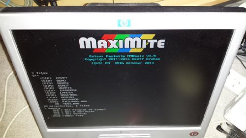

Posted: 04:37am 25 Oct 2014
Hi All,
Really appreciate the responses.
I would love to get this sorted as it is very annoying...but I fear it could be the PIC.
Sorry for the poor quality pictures, I did mention they were bad at the very bottom of my initial post
I have re-taken three more that hopefully are a little better.
Other than the dots on the screen in mode 3 everything else appears exactly as I expect & also exactly like screenshots i have seen on the net.
Today I had more of a play around with .mod files & copying from SD (drive B) to Flash (Drive A) and again all worked fine. All demo programs have run fine...
Here are the new photo's. The dot's are not so obvious in these ones, except maybe for that last picture.
Once again, thanks for you input. Much appreciated.
Cheers,
Shane

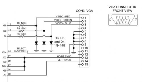

That is a very weird fault.. I cannot explain it looking at the schematic.
I would start by checking that the components R3, 4 & 5 are the correct value and that D4, D5, D6 are correctly oriented (There is a black bar on one end of the diodes that signifies the Cathode (the bar in the Schematic) that is connected to GND..
Use a multimeter to check that each of these Cathodes are connected to each other (means the orientation is correct).
Check that there are no shorts between pins associated with the video (these are on the left of the attached schematic) and their adjacent pins.. You may need a meter to check these.. a fine scalpel may be used to scrape between the pins if they look dodgy.

Posted: 08:31pm 25 Oct 2014

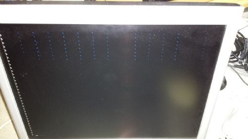

OK, here are three more screen shots of the 'dots', the last I promise
I think I have bored everybody enough...
The first is to show that on a 'CLS' the dots appear on row 8.
The second shows the dots scroll up to the top if you continuously press enter a scroll the screen, again you can see 8 rows of dots.
The Third screen shows that text does not over right the dots, and in fact sit probably a couple of pixels below the normal text line.
Even a full screen bitmap does not remove the dots, and depending on the background colour that the dot is in, the dot will then change to another colour.
Anyway, like I said, I think I have done the dots to death...sorry guys.
Thanks for all who took the time to reply.
Cheers,
Shane

Those last photo's are good.
Still no idea what the problem is unfortunately but the photos do show the position of the dots well and that might help...
