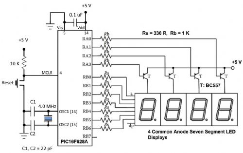

Posted: 10:45pm 23 Oct 2014
Hi Grogster,
see this picture:
You can see the µC outputs of the controller on the left side and the switched cathode on the bottom.
Frank
Posted: 11:20pm 23 Oct 2014
Ahhhhhhh - I see now.
A picture speaks a thousand words.
Would I then be correct in my assumption that the data-lines for the segments, and the cathode transistors are switching very fast - too fast for the Human eye - so it looks like a static 4-digit display, using your image?
OA47

Posted: 11:51pm 23 Oct 2014
Frank, that is a very cool representation. Can I congratulate you?
Frank N. Furter
Joined: 28/05/2012
Posts: 1160
Posted: 12:33am 24 Oct 2014
@Grogster:
You are right!
@Greame:
Thanks a lot but I only found it on the net with Google picture search...
Frank

Posted: 01:51am 24 Oct 2014
Frank,
A fantastic image, shows beautifully how it all works.
Grogs,
Yes only one segment is actually displayed at a time but the multiplexing is done so rapidly the eye cannot see the flicker. Well that's the theory.

Posted: 02:32am 24 Oct 2014
...you can often see the running segments when you look with a digital camera at a LED or a VFD display. The beat frequency composed of the muxing and the camera/LCD frequency makes it visible...
Frank

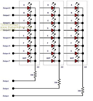

Posted: 04:13am 24 Oct 2014
There is another way but that only works for maybe 2-3 displays from MMBasic.
It will probably works for more displays when a C plugin is used.
This needs a warning though! If the program is not exact it can cause damage to the mcu or displays. So take care when you are going this way. Test the outputs before connecting the displays!
Basically what you do is using 7 output ports, one for each segment. (8 when you also want to use a dot)
The common cathode is then connected through a resistor with a output pin that will be used to select the right display. So one output pin for each display.
like this:
It works when ONLY ONE one of the 7 output pins is high and ONLY ONE of the select outputs is low.
Principle of operation is to start with all output pins connected to the segments low and the output pins connected to the common cathodes of the displays high except the one you are using as the first display. Then set the output connected to the right segment high to make it light up. Then set it low again and do the next segment. When all segments that should light up are done set the selection pin high. Then repeat for the next displays. Beware!! Never light up more then one segment!!
Advantage is very little extra components (1 resistor!).

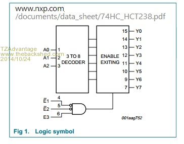

If you have less pins available you can use a 74HC238 to decode 3 pins to 8. This will actually prevent against programming errors as only one output pin can be active high at a time.
If you need more display then you can also use a 3-8 decoder like the 74HC138. This functions the same but is active low.
If you use both the 74HC238 and the 74HC138 then you can have eight 7-segment display with only 6 output pins. :) As long as you can change the pins fast enough.
Rmember this is not the normal way to connect 7-segment displays but can help when you not have enough pins or not enough room on the pcb.Edited by TZAdvantage 2014-10-25
