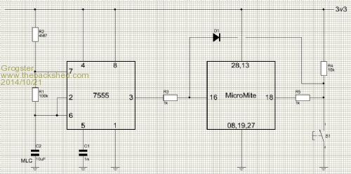

OK folks, I have built a test 7555 circuit, which seems to be working well.
The 7555 operates as an astable with R1, R2 and C2 setting a time period of about 35 seconds. R3 provides some current-limit protection to the MicroMite, and D1 prevents the 7555 from tripping the MicroMite via S1 during it's timing cycles. The MicroMite is woken every timer cycle, where it checks the condition of the battery, then goes back to sleep. The idea behind all this, is to maximize battery life, by not allowing the CPU to run all the time, sucking juice from the battery, while doing nothing but waiting for a button press.
If S1 is pushed during a sleep cycle, D1 pulls the WAKEUP pin low and wakes the MicroMite allowing it to process the button press. During S1 presses while the MicroMite is awake, the 7555 is still running in the background, but as the MicroMite is now awake, it just ignores the 7555 output till the MicroMite is put back to sleep again.
Can anyone see anything obviously wrong with this setup or suggest a better idea?

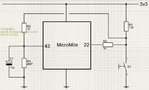

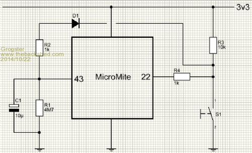

EDIT: Ahhhhh - forgot the 1k series resistor between the WAKEUP pin, and the switch to ground. I can wake the uM on button press now.
EDIT: OK, here we have the circuit as it stands now, and this seems to be working fine, including waking on command when S1 is pressed.
Edited by Grogster 2014-10-23
