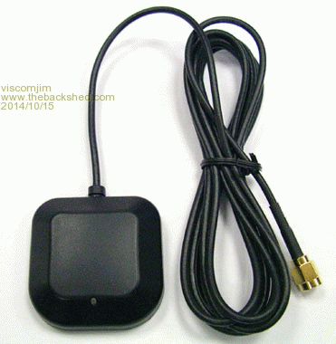

I need to use a gps module with uMite but the whole thing has to be in a waterproof box that will be mounted to a piece of heavy equipment for tracking purposes. Do the uBlox units that are mentioned above have the ability to use an antenna like this one that can be mounted elsewhere on the vehicle? If not can you recommend any units like that?

Yes, the uBlox is able to use an 'external' active antenna like that in your post.

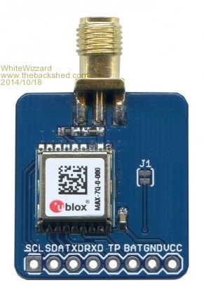

I am now stocking the uBlox 8 on a breakout board (PM me as not yet on website). See below for what it looks like (the picture shows a 7, but the 8 is a drop in replacement):
You can use various serial connection methods to simplify communications with it. I will retail the BoB at £30 each. Note: it also has provision to drive an active antenna so I will also be stocking an active antenna for £10 (but these are readily available on the internet if you can source locally).
I can't comment about a US supplier of the uBlox module (and what their Minimum Order Quantities (MoQs) may be). I have a UK supplier that places the MoQ of 500 and then sells them individually.
