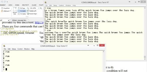

Posted: 05:41pm 13 Oct 2014
I am able to get reliable results with the clock set to 10kHz. Any faster then this, and the comms are garbled. This is byte-at-a-time writing. Master sends a byte, then waits for slave to acknowledge, then sends another, till it runs into a CR, then it stops. The tinkering continues....
EDIT: OK, I have it working now right up to 400kHz.

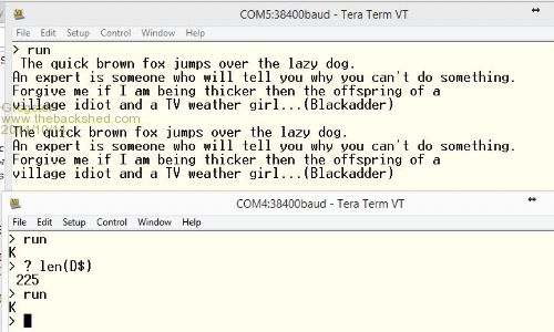

Posted: 06:23pm 13 Oct 2014
Working at 400kHz with a string 224 bytes long.

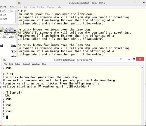

We're always missing the first byte of the message - not sure why at this stage, but if it was consistent, then a dummy byte could always be used for byte one.
EDIT: I have fixed the missing byte one, by adding a capital U to the start of the data string, as a data-slicer sync kind of thing. No missing characters now.
