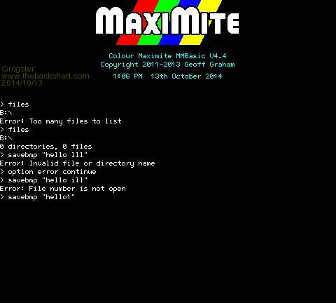

Posted: 02:04pm 12 Oct 2014
I can confirm this error - the same thing happens with me.
If I use a name such as HELLO1, this saves fine.
If I use something like "HELLO ILL", MMBASIC throws up an error - File number is not open.
This despite OPTION ERROR CONTINUE.
You might have found a bug perhaps?
EDIT: Hang on - I am using command prompt, so the error report is probably correct for that method - I will write a little code to test this.....
EDIT: No, you are right - even with a code, it still fails with a file number not open error on line 2, even though I would also have expected MMBASIC to just ignore this error and save the problem in mm.errno.

My guess at this point, is that the Option Error Continue just does not work with saveBMP(and perhaps loadBMP too - not tested). There are no problems with normal file reading and writing in this respect.(using option-error-continue and checking the mm.errno variable)
