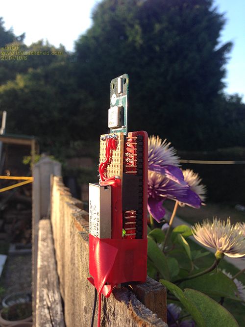

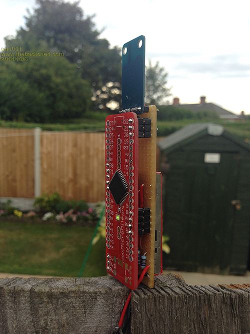

EDUPIC1 High Altitude Balloon tracker first successful flight completed
44 pin Micromite Lite from micromite.org
uBlox Max8 GPS module
Radiometrix RF Transmitter
DS18b20 Temp sensor
Single 1.5v AAA Lithium Energiser Battery
The DATA is compiled into a string and transmitted in RTTY over RF in the following format
$$EDUPIC1,941,12:59:55,5141.98759,00133.86900,09,18493.3,0,- 31.5,1.3*C538
$$payload,count,time,lat,long,sats,alt,flightmode,temp,batte ry volts,crc
Suspended on a small helium balloon it reached an altitude of 25,777m and a temperature of well below -30 degrees
Another flight is planned in the near future to an altitude of 36,000m +
Thanks to the WhiteWizzard for his invaluable assistance with coding :)

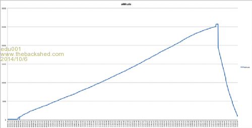

Here is the received DATA over time for 1 flight
2014-10-06_151046_EDUPIC1_Example.zip

Holy Cow that awesome. Looks like 6.5 hours flight time? Which radiometrix transmitter gave you that range on small powersupply and what did you use for a receiver? Also, do you need any kind of agency clearance to let a balloon go like that?

Some more details on the tracker
The setup is
ublox GPS connected to COM2
Radiometrix MTX2 transmitter connected to COM1
I read the correct NMEA sentence from the GPS filter out the unwanted fields/sentences and compile it into a string which is sent to the MTX2 for transmission on 434Mhz a 10mw signal can be received over hundreds of kilometers
There are quite a few receiving stations all over europe we decode the RTTY using fldigi software and send the data over the net to Spacenear.us check it out it will all make sense
The balloons are quite small this one is a foil
Launched on Saturday it covered 822km at 7000m ill post the details on that flight as soon as I have the data

Having worked with Jed on this project; mainly power saving techniques and a complex CRC code module I am in a position to elaborate on the above and how we maximised the battery life.
The 'set-up' comprises of a 44-pin MicroMite module plugged into an expansion board; the layout of which Jed takes full credit. On this stackable expansion board is a high quality GPS receiver, a high quality RadioMetrix Radio Transmitter, a standard PCF8563 Real Time Clock, and a very efficient StepUp booster.
High level operation is as follows. The MicroMite is normally in 'Sleep' mode. Periodically the RTC will wake the MicroMite which then immediately wakes the GPS module. The current GPS location is read along with some other data. The GPS is then put to sleep and the Radio Tx woken. A string of data based upon GPS co-ordinates, GPS altitude, and GPS Time is compiled and then transmitted at 50baud via the Radio Tx. The Radio is then put to sleep along with the MicroMite; ready for the next 'WakeUp'. During the time the MicroMite is awake, it is set to the appropriate CPU speed depending on the function it is performing - all in a bid to minimise average current drain.
The GPS has a typical current draw of upto 20mA while 'awake', and a similar current draw for the Radio module while transmitting.
On a wakeup every minute, the overall battery-life is a matter of days - remembering we can parallel batteries to provide longer flight times (but obviously at increased payload weight).

The flight we just did lasted 12 hours+ then went out of range it had about 40 hours battery life

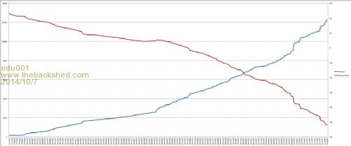

There seems to be a cold layer at lower altitudes, this graph shows how cold it can get I tracked it to -61 but the data was erratic but the Micromite was still running I think the battery froze :)
Data file 2014-10-07_062522_cold.csv.zip
