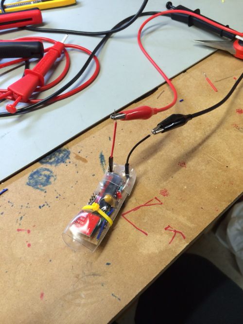

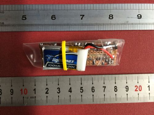

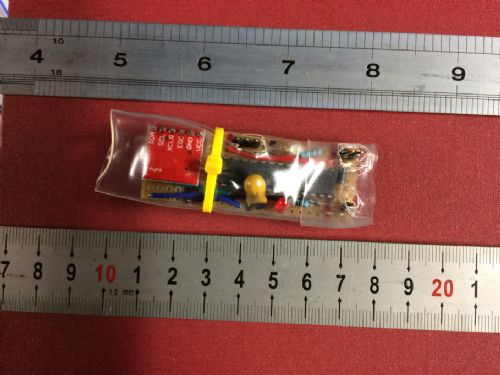

My first micromite project is complete - a model rocket altimeter. Fairly bare bones really - just the micromite, a BMP085 pressure sensor, and a pair of LEDs (more for debugging/testing), powered by a little 100mAh 1S lipo. I incorporated a 1N4001 in series with the battery to drop the voltage to 3.3V.
The on/off 'switch' is a jumper, which, when removed clears a header pin that I can charge the battery from.
I haven't included a display (weight/size reasons), so just power off the altimeter, connect to laptop via serial, turn on - the first part of the program displays previous flight data saved in the flight.
The most enjoyable electronics project yet!
