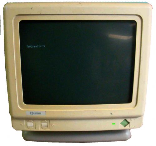

Yes until recently we used these horrible QUME QVT-321 VDUs
Now we use HP PCs with a SFF PC bolted on the back of the LCD Monitor and run PowerTerm for Windows. Much better and more reliable.
