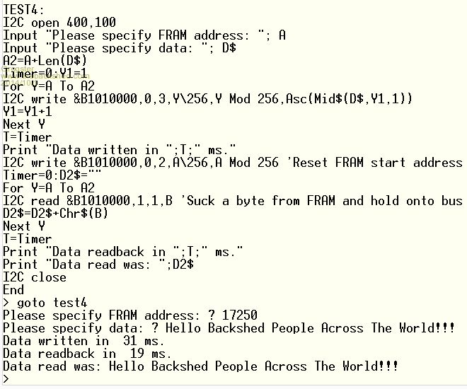

EDIT: I know where the * is coming from - address zero. If I change the line that resets the FRAM address to I2C WRITE &B1010000,0,2,0,1, that should fix that issue, as the FOR/NEXT loops will then jive with the preset address of the FRAM.Edited by Grogster 2014-10-02

I just cant get 'sequential' data-byte writes to work - I have to write the address and data byte as one command
Posted: 05:52pm 30 Sep 2014
Do you think that is the FRAM being difficult, or something in the way that MMBASIC is doing it's I2C?

[code]
TEST3:
I2C open 100,100
Input A$
For Y=1 To Len(A$)
MSB=Y\256:LSB=Y Mod 256 'Figure out bytes for address word
I2C write &B1010000,0,3,MSB,LSB,Asc(Mid$(a$,Y,1)) 'Write address & byte
Next Y
I2C write &B1010000,0,2,0,1 'Reset address, and send a STOP
B$=""
For Y=1 To Len(A$)
I2C read &B1010000,1,1,B 'Suck a byte out of FRAM & hold bus
B$=B$+Chr$(B)
Next Y
I2C Close
Print B$,Len(B$)
End
> goto test3
? Hello Backshed People!
Hello Backshed People! 22
[/code]
