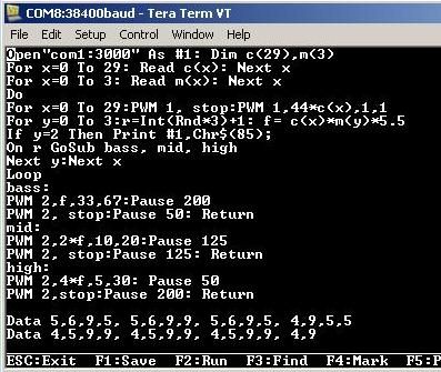

http://home.comcast.net/~mnjmiller/temper.mp3

> How are you doing that?
All PWM's summed with 15kOhm ... COM1 added with 3.3kOhm
add: Data 2,4,3,4
@ bottom
Edited by hitsware 2014-09-20

I'll ask a stupid question (because I do it so well and I'm more software than hardware).
When you say, "All PWM's summed with 15kOhm ... COM1 added with 3.3kOhm ", I assume you mean that the PWM's are connected to one point through 15k resistors and then the TX from COM1 is connected to that same point with a 3k3 resistor. That one connection point then becomes "audio out"? Thus summing the signals together into one signal? The resistor are there to protect any of the pins when they go low since there's a good chance that when a pin is low, some other pin is high.
Precisely.
The values can be adjusted for mix as the 3k3
(COM1 is the percussion)
