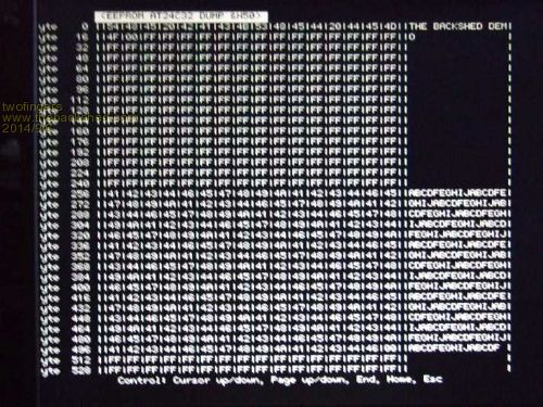

Hi all,
this is my new I2C EEPROM Maximite Library v.82 for AT24C32. Many of us know this 32kb chip from cheap DS1307 or DS3231 RTC modules. Most Parts (excluding eeDump? and eeMon) of this library should also work with all 'Mites - I hope so! I did some research to find out the "wear out" behavior. I came to the conclusion that a read event after a write event only after one second delay reliable results delivers (a write takes 0.005 sec or even less!). Therefore I removed the verify routines for short writes, but I kept it for eeErase ... and as demo in eeSaveF4 (not reliable!!).
In most cases I think you dont need a verify because the endurance is 1 Million Write Cycles (says ATMEL) or even more. My test EEPROM showed its first weakness after 3.5 Million Write Cycles! This does not necessarily mean that the data are retained for 100 years. With this EEPROM we can do a reliable Data Logging. There is space for more then 1000 floating point numbers (eeSaveF4).
Please note: The I2C Address must be set for your specific EEPROM!
On Maximites using eeMon you can now easily scroll through the EEPROM content.

Print "Writing at 0 'THE BACKSHED DEMO'"
eeWrite$ 0,"THE BACKSHED DEMO"
For i = 1 To 25
a$=a$+"ABCDFEGHIJ"
Next i
A$=A$+"ABCDF"
Print "Writing at 256: "A$:Print:Print
eeWrite$ 256,A$
Print:Print "reading back:"
Print eeRead$(256)
Print
Print eeGet$(0,17)
waitkey"press any key for eeMon"
eeMon

Sub eeMon 'eeMonitor
' Shows content of EEPROM
' You can navigate and scroll through
Local i, upArrow,dnArrow,pageUp,pageDn,LinesPerScreen,KeyText$
Local EndKey, HomeKey, EscKey
upArrow=128
dnArrow=129
HomeKey=134
EndKey =135
pageUp =136
pageDn =137
EscKey =27
MsgPos =62*6
LinesPerScreen=MM.VRes/12-3
KeyText$="Control: Cursor up/down, Page up/down, End, Home, Esc"
Cls
Font #1,,1
Print @(60,0)" <EEPROM AT24C32 DUMP &H"+Hex$(I2CPROM)+"> "
Font #1,,0
For i = 0 To LinesPerScreen
eedump i *16,16
Next i
i=i-1
Print @((MM.HRes-Len(KeyText$)*6)/2,MM.VRes-12) KeyText$
Print @(MsgPos,0) Space$(20) 'clear error message
Do:AscKey=KeyDown:Loop While AscKey=0
If AscKey = dnArrow And i < 255 Then
scrollup
i=i+1
Print @(0,MM.VRes-24);:eedump i *16,16
Else

I have been able to get twofingers code to read and write to the eeprom that comes with rtc modules, as noted in the code it was written for a MaxiMite.
I have the code running on a 28pin 150 using 4.5D, some of the origoal functions have not been included as it specific commands formatting commands for the MaxiMite.
Anyone who wants to tidy it up further is welcome, I have yet to try it on a 170 and 4.6(beta).
Cliff

' EEPROM-Library v0.82
' by twofingers 09-2014 at TBS
' with parts from MMBasic Library
' for AT24V32 (32kBit EEPROM)
' at DS3231 or DS1307 RTC-Modules etc.
'Modified by Centrex to run on uMITE
'28 pin 150 MMBasic 4.5D (11-2014)
'The origonal here
' http://www.thebackshed.com/Forum/forum_posts.asp?TID=6917&PN =9
' Modified (q&d) for MMBasic 4.6B (03-2015) by twofingers@TBS
' needs VT100 emulation for eeDump,
' eeWriteStr: writes a string to address
' eeRead$ : reads a string from address
' eeGet$ : returns an amount of bytes from address
' eeWriteB: writes 1 byte to address
' eeReadB : reads 1 byte from address
' address may be between 0 to 4095
' eeSaveF : writes a 32 bit floatinpoint number
' eeSaveF4: writes a 32 bit floatinpoint number
' at EEPROM addresses divisible by 4
' (faster then eeSaveF)
' eeLoadF : reads a 32 bit floatinpoint number
' back from EEPROM using PEEK and POKE
' needs eeWriteB and eeReadB
' eeErase : deletes the whole eeprom w. verify
' this has been remmed out for the time being
' eeDump : shows content of eeprom or parts
' eeMon : displays whole eeprom content (scroll)
' remmed out for the time being
' I2CPROM (I2C address of your EEPROM)
' must always be defined globally
' Remark: A check for defective Bytes
' has a latency of ~1 sec !!
' Therefore one second should be elapsed after
' each write event and then follow a read/compare,
' if a verify is required.
' This code may be freely distributed and
' changed. Provided AS IS without any warranty.
' Use it at your own risk.
option default Float
' Demonstration code
dim integer I2CPROM = &H57 'I2CAdress of EEPROM
'if unknown please use the i2CSanner
'or the resp. datasheet
dim integer i
dim float rnd_val
dim string Your_Name$, TestStr$
VT100_CLS
Print "WARNING: THIS DEMO WILL ERASE YOUR EEPROM!":Print
Print "The Monitor functions has been remmed out for the time being."
Print "---- This demo requires a VT100 terminal -----"
Print
waitkey"Press any key for eeSaveF4 demonstration (or CTRL+C to abort)"
Print "writing 10 Rnd() numbers into the eeProm"
For i = 0 To 9 'fill with 32 bit floats (= 4 bytes)
rnd_val=rnd 'get a random number
eeSaveF4(i*4,rnd_val)
Print rnd_val
Next i
waitkey "press any key for eeLoadF (reading back)"
For i = 0 To 9
Print eeLoadF(i*4)
Next i
waitkey "press any key"
VT100_CLS
Print "reading (4096 bytes)... (takes about 5s)"
eeDump ' this will dump the whole of the memory
'The following require a lot of modification to work on the uMITE
'waitkey"press any key for eeMon"
'eeMon
Print
waitkey"press any key for eeErase"
VT100_CLS
eeErase
print
waitkey"press any key for eeWriteStr + eeRead$ + eeGet$"
VT100_CLS
For i = 1 To 25
a$=a$+"ABCDFEGHIJ"
Next i
A$=A$+"ABCDF" '255 characters
eeWriteStr 256,A$
Print:Print "reading back a 256 bytes string: (eeRead$)"
Print eeRead$(256)
Print
Print
LINE INPUT "Your name?: ", Your_Name$
Print "Writing at byte pos 0 'Your name' and 'THE BACKSHED DEMO END'"
TestStr$=Your_Name$+" THE BACKSHED DEMO END"
eeWriteStr 0,TestStr$
VT100_CLS
Print "Dump first 512 bytes:"
eeDump 0,512
Print:waitkey "press any key for reading back: (eeGet$)"
Print eeGet$(len(Your_Name$),len(TestStr$))
end ' end DEMO
