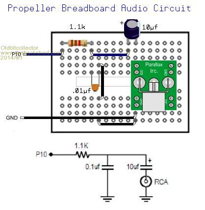

Posted: 04:09pm 31 Aug 2014
I'm running it on an audio circuit that looks like this..
Then into a set PC speakers..
