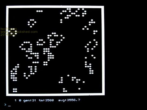

Just for fun and to train my abilities in MMBasic programing, I've written this piece of code.
Some guys here probably still remember this The Game Of Life program from the very old days (pre-PC era). In order to increase the speed I use very short variable names and only a few comments.
'* MMBasic 4.5 for Maximite/Duinomite
'* twofingers at TBS 08-2014
'* No warranty, provided at your own risk.
'* This code may be freely distributed without charge
'* John Conway's
'* "Game of Life"
'* a code example/benchmark

I have again taken a critical look at the code and a unnecessary subroutine found.
This
Sub plotworld
For x = 2 To C_x1
For y = 2 To C_y1
println (x,y,w$(x,y,t))
Next
Next
can be deleted. Its a relict of a earlier version.
Download: 2014-08-30_101326_TBS_Life_v1...01.zip

  Quote  some hardcore mathematics going on in that code
not really, simple counting. Just looks confusing.
Michael
