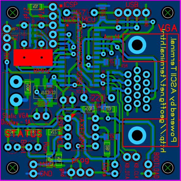

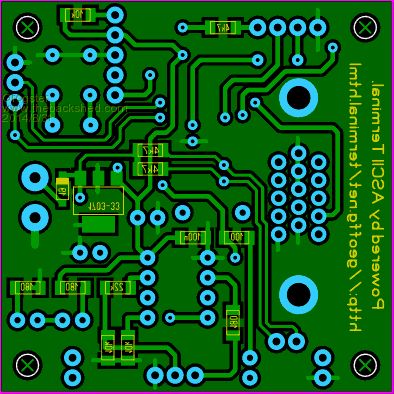

I have developed a board using the VT100 and a PICAXE 08M2 chip.
The PIC32 handles the VT100 side of things, and the PICAXE chip basically just acts as a serial memory of sorts, allowing you to setup a screen(using all the VT100 codes etc), which is then sent to the VT100 PIC32 chip.
The idea being for a pre-programmed VGA display screen for certain applications. I developed this, as I needed a specific screen to show on the VGA when my main system was in remote-access mode via the WAN. When this is requested, an electronic KVM switch is tripped by the main system, which then switches to the display message shown by this unit. Once remote-access is completed, the system reverts to the standard VGA supplied by the MaxiMite based system.
Bench-testing is working great. Not sure if this can be useful for others or if it is really more specific to MY needs, but there you go.
Board is 50mm square, including the VGA socket, baud-rate pads, colour select pads, PICAXE 08M2 message store, LED's etc. In my case, I selected RED as the colour for the VT100 used in this way, as red is often used to indicate something important or something needing attention etc. Using iTead Studio, you can get 10 of these boards for only US$9.90
Here is a quick photo:
EDIT: This is still a work in progress. Although the test version works fine on the breadboard, I have yet to actually get these PCB's made - I should clarify that point...
Edited by Grogster 2014-08-29

Posted: 09:06pm 28 Aug 2014

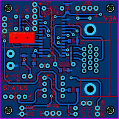

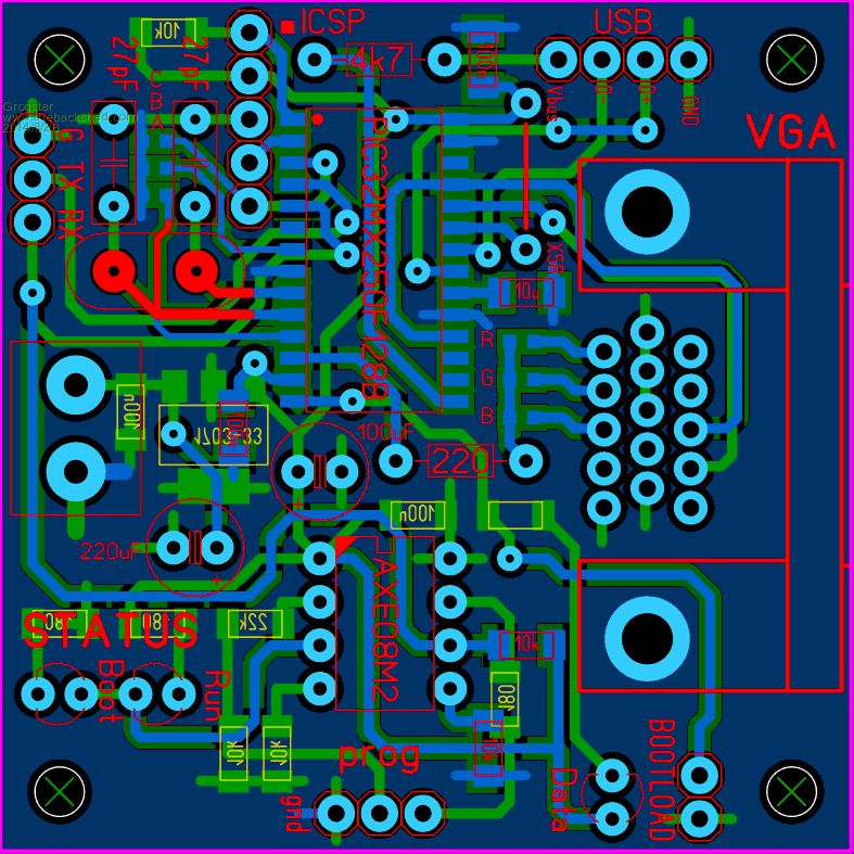

Here is updated image:
This PCB now contains keyboard data and clock pins, although I just could not find out how to squeeze in the two pull-up resistors + 5v supply for the KB, so these are just the two main pins. Using a KB would be easy enough, with the addition of a 5v supply and resistors across the CLK and DTA lines back to the module - real estate is getting pretty scarce on this board now!
Board also now has provision for multiple messages using a string of buttons on an ADC pin of the PICAXE - you could program several messages into the PICAXE, and select the one you wanted with buttons. Currently no way to select colour - it will have to remain fixed. With a bigger PCB, we could squeeze in the 4066 idea of Rob's, but not on this board!
Posted: 09:33pm 28 Aug 2014
Groggy,
You can always mount standard 1/4w resistors vertically, that way the legs can be spread what ever distance is needed to make a connection, ie. one res can have 0.1" spacing and another could be 0.2" if you cant space closer..
Can you post a pic of the bottom layer to see what the tracking looks like in that area?

Posted: 10:25pm 28 Aug 2014

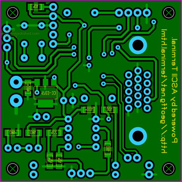

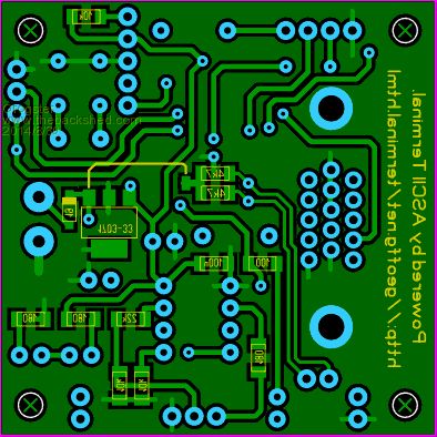

@ Mick: Here is the C2 layer and it's overlay.
Please note that in this board, BOTH the top and bottom ground-planes are at ground potential. The top copper layer GP is not at 3v3, as might be expected with a double-sided GP board.
@ Jim: Yes, that's a point. I will build the board without the 1k8 and try it. I have pulled my breadboard arrangement to bits now.

Posted: 01:05am 29 Aug 2014
Grogster,

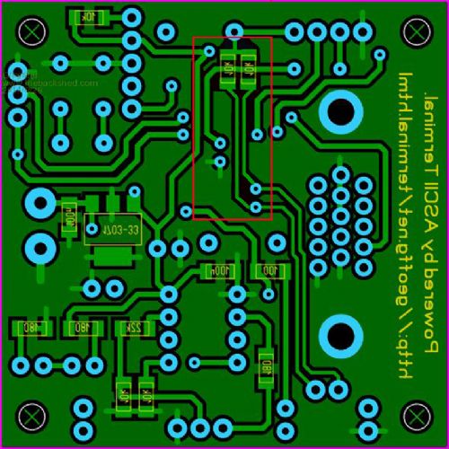

You can do some minor alterations and get the pullups for the keyboard on.
See this mockup.. just a quick photoshop shove job.
Posted: 01:17am 29 Aug 2014
Whose a clever boy, then? (rhetorical!)
VERY well spotted.
I will add this to the layout.
EDIT: This will ONLY work, if USB is connected, as you are tapping into the +5v Vbus of the USB connector. However, I think I can rework this idea. Edited by Grogster 2014-08-30

Posted: 02:53am 29 Aug 2014
Hi Grogster,
I usually do the same.. I like GND top AND bottom as I feel that it is better for shielding.. plus I feel having 5v on the top plane is risky and more likely to to short to metal connector shells etc.
