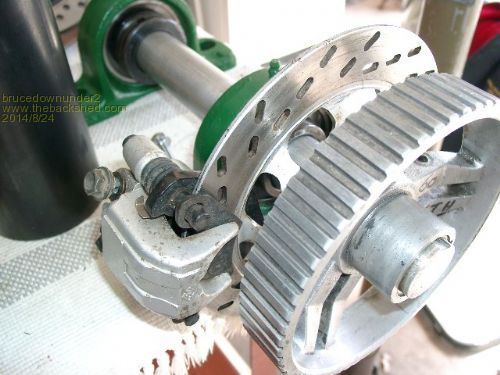

Anyhow, lastly, here's a pic of what I thought I might do some years back..
Still have plenty of this stuff ,,,so may fiddle a bit more.
Thanks for you guys ,but i really don't think you are into what i wanted.

Thanks for your interest, thats a motorcycle disc brake and caliper in the Pic.
Bruce
