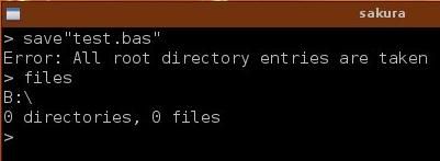

When trying to SAVE:
1) Started getting intermittent 'SD card is write protected'
2) With ColorMaxiMite powered, pulled and reinserted SD card
( seemed to wipe all files )
3) Now see above pic ^
4) SD ruined ? ..... MaxiMite ruined ? .... Missing something simple ?

It may have been a 'final straw' in my episode, but not the whole problem at all.
My first symtom was intermittent 'SD card write protected' when I'd try to save.
I couldn't find any referance to that in the manual. It happened more and more
until I couldn't save at all. After (in desperation) I pulled the card (with power
(not thinking straight)) came :
Anyways after reflashing the PIC everything's hunky dory ....
Begs the question : Things not to do to corrupt your chip ?

  Grogster said   What is the general consensus around the forums here, with the removal and insertion of SD cards on the MaxiMite series of computers, while powered?
On the original Maximite and Colour Maximite you can swap the SD card without any ill effects because the SD card holder used in them provides a card-present signal to MMBasic which tells the interpreter to re initialise the filesystem driver if the card is removed.
The Duinomites don't have this signal but by using a trick MMBasic can still tell when a card has been swapped so they are OK also.
On Circuit Gizmo's boards I am not sure. From what I remember the original monochrome CGMMSTICK1 does not signal a card change so you have to cycle the power after a card change while the colour CGCOLORMAX2 does provide the signal and is OK.
All of this assumes that you do NOT remove the card while MMBasic is writing to the card or when files are open on the card. Both are no nos and will result in a corrupted file or filesystem.

Some days ago I had a similar problem:
Suddenly my AUTORUN.BAS didn't run on my TFT-Maximite at startup because my SD-card seemed to be empty. Plugged into a cardreader I got a "file system error" message. Further investigation showed, that the MBR was ok but there was a large block of zeros where the first FAT should have been, and the second FAT was badly demaged (the beginning was overwritten with zeros). Luckily the data area was ok, so with the help of some tools (PhotoRec and a hex-editor) I got all files back but it was a hell a lot of work!
I don't know what exactly happened, but I think I caused a brownout: I didn't use the reset button to restart the TFT-maximite, but instead I unplugged the power cable for a short time.
Afterwards I discovered that if you reconnect power at the right (or wrong) time, when the display isn't illuminated anymore but the capacitors on the board have some electrons left, the PIC may get into an undefined state where strange things can happen. Most of the time it won't startup properly or will freeze during startup, but I've also seen error messages that would normally show up on completely other occasions.
