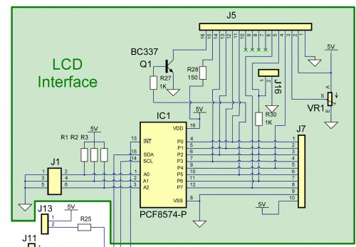

I tried it (using LCDI2C_Init &H20,0,4,7,5 ) as I have it set for 20H and BLight is on P5.. but it shows the following:
press 1 Full 4 lines of solid blank
press 2 backlight off
press 3 backlight on still blank
press 4 backlight on still blank
press 5 backlight on still blank
press 6 flashing block cursor on line 2 pos 2
press 7 rapid blinking all over the screen (nothing intelligible)
Here is the schematic for the LCD module
EDIT **** J5 is the LCD Module.
Mik

When you say D0-D3 I assume you mean LCD D4 to D7 (as 4 bit mode use the high order bits..
The only correction to the above is Backlight is on P5 not P6.
A full list is as follows:
P0 = DB4
P1 = DB5
P2 = DB6
P3 = DB7
P4 = RS
P5 = BackLight
P6 = RW (NO RW control so RW linked to GND)
P7 = EN
A modified circuit of the LCD interface is here:
2014-08-20_021053_LCD_Circuit.zip
PS. I do have working code for the display if you need it (I doubt you do)

LCDI2C_Init I2CAddr,NibPos,RSBitNo,ENBitNo,BLBitNo
LCDI2C_Init &H20,0,4,7,5 looks correct to me
P0~P3 -> DB4~DB7 -> 11~14
P4 -> RS -> 4
P7 -> EN -> 6
P5 -> BL -> 15 via Q1
0V -> RW -> 5

I don't know if it matters but I have LCD pins 7,8,9 and 10 (D0-D3) on my displays grounded, looks like yours are open on the schematic.
Good luck,
Lou
Yes Lou, Mine are floating but I have always used them this way..
And as they work with my hack of John Gerrards code I dont think that that is the answer..
