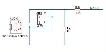

I'm struggling to find info regarding the hardware hack to allow the full PWM signal from the sound output.
I've got a standard Duinomite, as well as a Mega. Ideally I'd like to switch the output level to suit sound OR PWM.
Has anyone got a closeup shot of the board and could circle the offending components for me? I have tried in the past but couldn't be 100% certain, and now I actually have need of the PWM output.
Thanks for any help.

I have Mega.
You can see R39 needs to be removed
(trusting schematic and silkscreen)
R39 and designator are easily seen
on board just behind the audio out jacks.
I have removed similar by breaking
off with ice-pick ...
