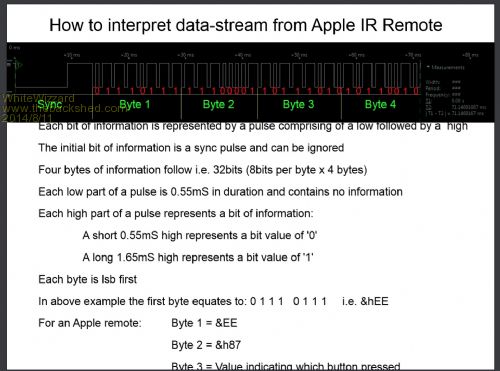

I recently needed a method of selecting options & menu settings in a recent MicroMite project design. Initially I used a rotary encoder complete with push button and RGB led.
However, when it came to casing the project (an LED matrix clock/thermometer) the rotary encoder just made it feel 'horrible'. So I rattled my brain and thought Why not use an Apple IR remote? (like the one shown below)
I thought if I add a simple IR receiver to my circuit and write some code then I should be able to get things going with the end result of a nicely designed remote (only cost £15 brand new) and no 'horrible' buttons on my clock.

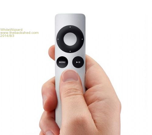

Note: The remote has 7 buttons which can provide full menu navigation and option selection.
I studied the datasheets and have ended up with a nice interrupt driven subroutine. The only additional component I used was a TSOP4838 and connected as shown in the MicroMite User Manual (Infrared Remote Control Decoder section).
I will send the details to Dave so he can post it on his excellent mmreference website.
In the meantime here is the debug code I used to get the required result (comments included).
IF YOU WANT MORE EXPLANATION THEN PLEASE PM ME!!
Hope some of you find this useful to include in your own projects . . . .
WW

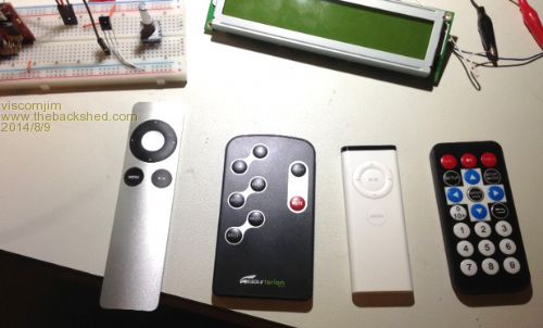

White, this is very cool. I am super impressed. Quick question, as a newbie, does this interrupt routine take a long time to do its thing? What happens if a key is held down, does it repeat? It is late here so can't try it right now but will do tomorrow after work. Again, nice idea and implementation!!!!
edit...
do you know if this works with the old style apple remotes?
sorry for crappy pic...
Edited by viscomjim 2014-08-05

Posted: 07:07pm 03 Aug 2014
Yes it will but you may need to add a different value to check for the Centre button.
This is easy to do; simply run the code and it will display the
value of the button pressed. Look at the third byte (from the four bytes returned) and add this value into the 'checking' at the end of the code supplied.
Different logic will be required for other NEC protocol remotes as their waveforms may be a longer duration (in which case you will require a bigger initial sample array).
The byte values returned will then need to be deciphered.
However, that said, the core of the code can be used to convert the NEC protocol into byte values.
Good luck; let us know how you get on . . . .

Hi All,
So far, WW IR code is working great with the following remotes I have. What fun!!!
I will be using the white older apple remote instead of a rotary encoder (just like WW) on a project for my mother in law... I think this will be easier for her to navigate. A gutted vintage table top radio that will have a uMite controlling an MP3 player with a small amp. The SD card will have many hours of Old Time Radio programs that can be found on the web as mp3 files. There are so many old time radio programs available that it will probably take a year to listen to it all. My personal favorite so far is the "whos on first..." from Abbot and Costello. I am even throwing in some real old radio commercials for products I am sure she has heard of, but I haven't. The old cigarette commercials are kind of funny too.
Thanks for the code WW.

Just a quick update... The apple remote is amazing when it comes to range. I tested this with several other remotes I had laying around and I can say that the apple white and aluminum version beat the rest by a factor of almost 3 in range. I don't know what they do different, but it truly works that much better. I did check the batteries to make sure the test was fair. At certain ranges the others also had corrupted data which I expected as the distance became larger, however that was not the case with the apple ones.
WW, did you try any other remotes and see a significant difference with the apple ones?

I did not try other remotes - this was purely an exercise to get the elegant & stylish Apple IR remote to work.
And the main reason for this (apart from looks) is as you say, the range is outstanding. In a 4m square room, no matter where I point the remote (and no matter where the MicroMite Rx, it just works!.
I reckon they drive the IR Tx LED at an above average current to get the increased performance.
Also, they only transmit the 'button' message once; and then if the button is held down, every 100mS is a much shorter message confirming button still pressed.
This is a sensible design: blast 32 bit (4 byte) message once at above average current (70mS), then a short (11mS) repeat message (sync bit + stop bit) every 100mS.

For anyone interested, here is an overview of how to interpret the Apple IR remote message.
It shows a Logic Analyser screen-shot (download below) of the IR signal; along with instructions on how to interpret it.
2014-08-11_163758_Interpret_Apple_IR_Remote.zip
Somewhere the formatting got messed up between Windows and iMac.
For completeness, Byte 4 = Remote ID.
And the values of the button press (Byte 3) can be seen in the code previously posted.
Any questions then feel free to ask . . .

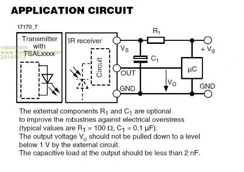

Hi White, I am not sure how far along you are on your project, but I have come across a weird problem with mine.
While running the code, all the buttons show up perfectly on the terminal when pressed just like they should, however, If I press a button, and then just let the remote sit there (not pressing anymore, just one press), randomly the last button pressed will magically print again like it was pressed again. There is no specific timing to it, it just happens.
It doesn't happen fast, just here and there. At first I thought it was noise being read by the interrupt pin, but looking at the code, you check 4 bytes of data before it can actually print something to the terminal. It doesn't matter which button I press, as long it is the last button pressed, it will randomly "press" again. I checked this with two different white apple remotes. Did you implement any kind of noise filtering between the TSOP4838 and the uMite in your project? Could that actually be the problem? I am stumped.
Edit...
I just did a bit of googling and came across this. I might give this a whirl tonight to see if it makes a difference. Also, are you powering your tsop4838 with 3.3v or 5v? I'm using 3.3v, maybe another problem.

Posted: 06:16am 13 Aug 2014
@viscomjim
I am using 5v and no problem observed here. No other components - just connected as per User Manual.
I will play with this later tonight to see if I can re-create your issue (will run at 3v3 first).
Be in touch in a few hours . . . . .

Thanks White, I will first try 5v also. Maybe that'll do it. The data sheet says 2.5 - 5.5v, but we'll see.
edit...
a little more googling and looking at the datasheet shows this...
as does quite a few sites. I will give this a whirl also when I get home and see if it makes a difference. I will keep you posted.Edited by viscomjim 2014-08-14
