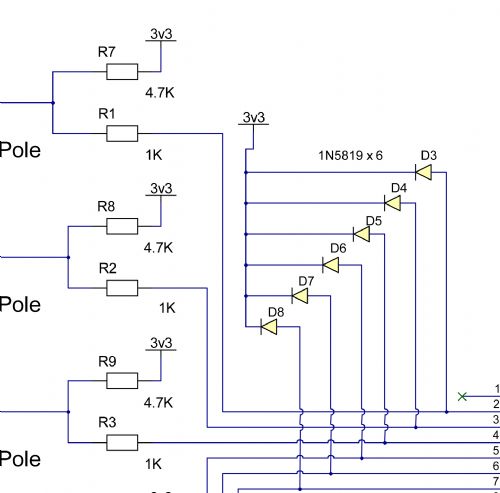

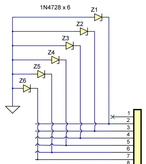

I think I will share a recent lesson I just learned by the design of a new PCB which I will probably release details of later tonight after I give it another look over before I send it off for manufacture.
I wanted to protect the analog inputs of a uMite from the possibility of 12V DC being applied so I naturally designed the input to be ZENER protected (through a 1k Resistor) as shown here (the resistor is not shown), using 3v3 Zeners.
But when I started doing some software tests I was stunned to see that the analog readings were all over the shop.. (OK I understand that close to 3v3 it will taper a bit) but this was WAY out from what I expected from a resistor voltage divider on the input. I scratched my head an eventually cut off the ZENER and shock horror the readings were spot on what I calculated they should have been.
I then decided I needed to use 3v6 Zeners to try to get the drop off slope closer to the 3v3 max but this made little difference.
What I have finally come up with is this circuit.
Which works extremely well. The diodes are Schmidt trigger Schotky types and they are fast acting and low forward voltage drop.
The expected readings were totally unaffected by the presence of the diodes, so I was happy with that. I crossed my fingers and applied 5V to the 1k resistor (simulating an overvoltage situation) and was very pleased to see the voltage at the input was around 3.46V (Actual power supply gives 3.29v).. Yippee it worked..
Now for the big test I applied 12vDC and crossed my fingers and lo and behold it worked perfectly, the voltage at the analog input pin was clipped at 3.57V just under 0.3v higher than Vcc.
Now reading the specs of the chip it states that the operating voltage can be as high as 3.6v so I am happy that it is unlikely to blow the input pin, although the specs state the max input voltage should be Vcc. But I figure that this is protecting against a situation that `should NOT' happen unless someone mis-wires to the device and is probably the best I can do given the circumstances.
Sorry for the long winded post but I think this could be educational to others thinking of the same idea.

Posted: 05:43pm 01 Aug 2014
I thought of diodes similar to this concept, but I must be lacking in understanding a little, cos using your image above, if you apply 12v to an input, does this not go roaring through the diode to the 3v3 rail, putting 12v on your 3v3 supply, and blow EVERYTHING connected to the 3v3 rail, and not just the single input pin?
I am guessing I am missing something here...
I would have thought the first image with the zeners and load resistors to deck would have been the way to go, as you yourself did initially.

As I said, probably missed in the war & Peace that I wrote, they are fed via a 1k resistor as shown in this slightly larger view of the circuit.
EDIT***
Going through the 1k it would only allow (12-3.3)/1000 or roughly 8-9ma max current flow.
P.S. The bottom line is it works.
Edited by bigmik 2014-08-03

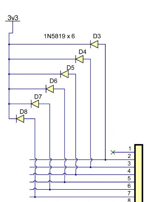

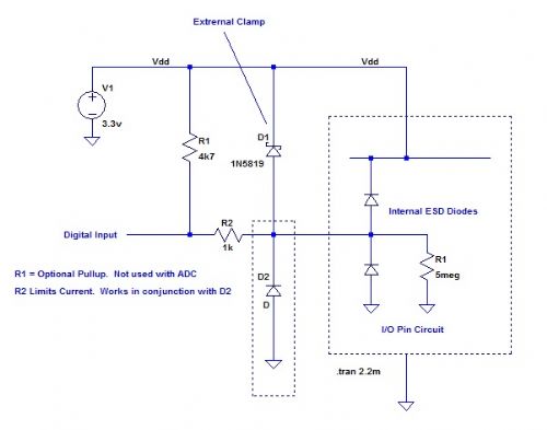

Grog,
The circuit may make more sense to you if drawn differently. It is a simple diode clamp circuit that you have likely seen many times. The diode does not conduct current until the voltage approaches Vdd. The higher the voltage the more the diode conducts, keeping the voltage at the PIC I/O pin at no greater than Vdd + .2V
(I added D2 which also adds protection again voltages below ground.)
Note that the PIC already has internal protection (ESD) diodes on all digital capable Pins except MCLR. The External Diode(s) offer more protection.

Hi Goeytex, Grog, others,
I omitted the Diode to Gnd (D2 in the above schem) in my circuit as there `shouldn't' be any possibility of a NEGATIVE voltage being applied, but there was a reasonable possibility of 12V being applied.. It was when I tested the circuit and found that it did the job and did the job very well that I decided to post it for all to use in their designs..
I probably should have taken the time to draw a better circuit rather than cut out segments of my one.
My main point was that Zener diodes were totally unsuitable for protection of an analog input.

Hi Mick,
My inclusion of the second diode was not to suggest an error on your part, just that it could be included if desired to offer added protection. In the majority of cases the internal ESD diode will handle negative transients as long as the series resistor is included.

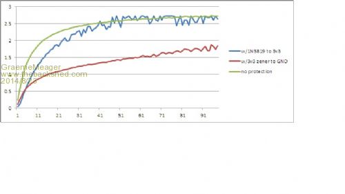

Mick & other interested TBSers I did some quick testing with overvoltage protection on the micromite. Set a PWM output into a diode and 100n cap to generate a variable voltage and then read it via a 1k resistor on an analog input with no overvoltage protection, 3V3 zener to ground and 1N5819 to +3V3.
Here is the code:
SetPin 26,dout
SetPin 24,ain
Pause 100
For f=20 To 1000 Step 10
Print f;",";
PWM 2,f,50
Pause 1000
Print Pin(24)
If Pin(24)>2.99 Then End
Pause 200
PWM 2,stop
Next f
Here are the results:
As you can see both types of overvoltage protection alter the way hat the analog inputs see the voltage.
Any thoughts?

Mick, I hear what your saying but the green curve which is smooth is using the same diode and cap.

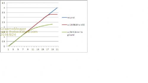

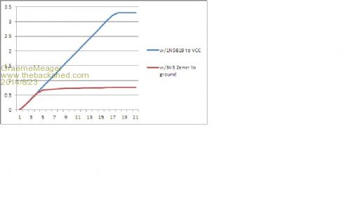

Mick and others,
To avoid the diode doubling issue, I did the test by stepping a variable power supply and the results are in line with Micks findings and recommendations.
Thankyou for clearing up my confusion.
