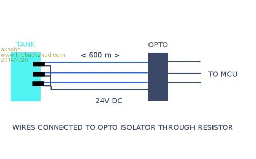

Hi,
Just for clarification I've included a diagram of the cabling:
So, I would need to figure out how to get a ground wire (I only have 24V, which is looped back through the float switch to the opto)...

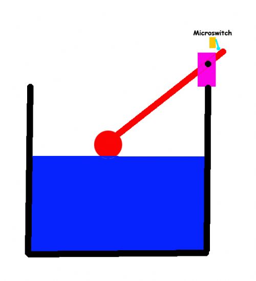

I would do something like this:
The Pivot and microswitch are OUT of the tank and the long part of the arm is in the tank.. Use the most appropriate sized ball for the job.. BASKETBALL for huge tanks (held on by a wire cage) or pingpong ball if only small tanks.
You can add a threaded bolt onto the top of the gimble to give your self some adjustment.
Good Luck

Posts: 6630
Posted: 01:48pm 29 Jul 2014
As much as I like electronics, I agree with Mick.
As well as a longer arm and bigger float, you could try a large float on a rope going over a pulley.
The other end of the rope has a counterweight on the outside of the tank.
This acts as a visual indicator and you can use it to operate the microswitches.
JimEdited by TassyJim 2014-07-30

I like the ball idea, but I was wondering if it wouldn't then make sense to just extend what I have now first to see if that helps? The floats are magnetic I think, they have an electrical contact when closed and they are fully waterproof. So I thought just extending the arm to give it more lift and weight would perhaps solve it?
I will certainly do some more thinking about the pulley idea, maybe putting the float in a PVC pipe would avoid different probes from getting tangled...
