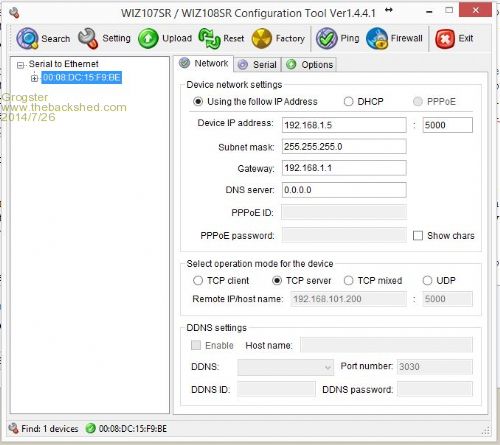

I am playing with the WizNet107SR network-to-serial module, and have had some basic success.
Armed with the module, a suitable PSU and the configuration tool, I was able to find the module on my network, and set it's IP address so that it is in the same subnet as the rest of my network, which is the very common 192.168.x.x
I can ping the module from my other machines - yay!

Here are my current settings:

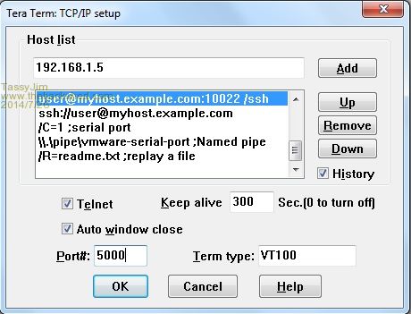

Does TeraTerm need the port number along with the device Ip address??
eg. 192.168.1.5:5000

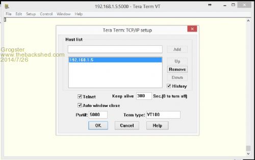

Posted: 06:10pm 25 Jul 2014
Good thinking - tried that - refused. I put the 5000 in the port box that is on the TT window. I will try it as part of the IP address as you have written....
EDIT: 192.168.1.5:5000 asks for authentication, which is one step up on where we were before - I left the TT port number as the default of 22.
Next, I changed the protocol to Telnet, and tried to connect again, and this time ir worked! Reading the manual a bit more, that makes sence, as Telnet is the supported protocol, so it says on page 21 - opps...

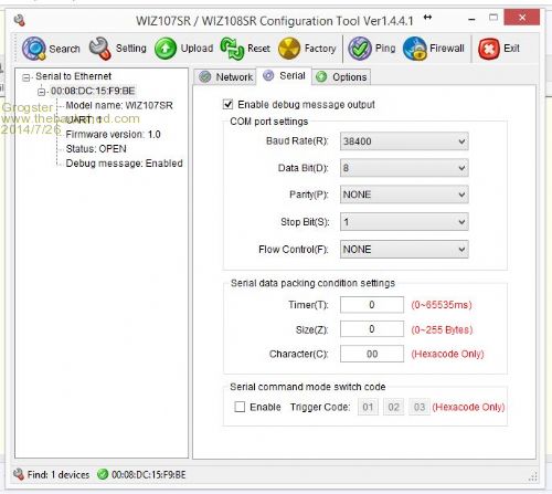

Here is how I have the 107's serial port setup:
Basically, default settings, and the uM is talking fine via standard serial on 38k4, so I know that part is right.

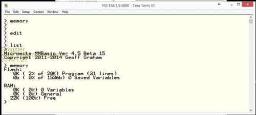

Posted: 07:35pm 25 Jul 2014

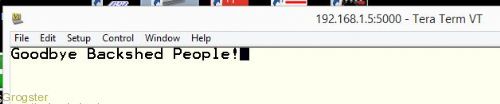

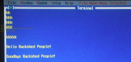

SUCCESS!!!
RS232 comms are working.
From laptop terminal:
...and on TT on the main machine, via the network:
You only see the goodbye message here, as I changed the font size in TT once I was getting something, to make it easier to read, that is why the hello message is missing from the TT screenshot.

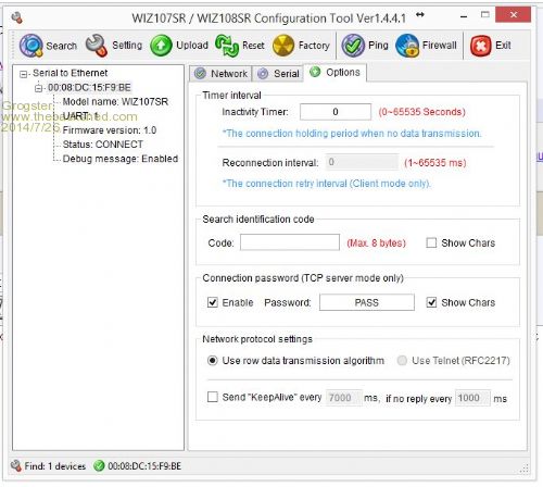

Posted: 09:00pm 25 Jul 2014
The module software included a password, but I am not having much luck at setting it:
Note that for testing purposes, I have set this simply to PASS.
I can still connect to the module as before, but as soon as I type ANYTHING in TT, starting with 'P', the connection is closed. Don't know why at this stage, but if I can make the password bit work, then this would provide some degree of security against port scanners.
Manual says:
  Quote  This function is available only when WIZ107SR works in server mode. If this function is enabled, the remote client should send the password to WIZ107SR before data transmission. Please, note the password is case sensitive.
So, not sure what I am doing wrong here, but it is not liking my test password attempt at this stage. Can anyone see anything I am doing wrong here?
Posted: 09:08pm 25 Jul 2014
Try with the password disabled for a start.
Try setting network protocol to Telnet
Posted: 09:16pm 25 Jul 2014
Password disabled, and it works fine.
Telnet is greyed out - the radio dot has to stay where it is.
Telnet WAS selected as part of the connection from the TT end of things.

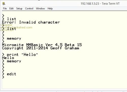

Posted: 03:47pm 26 Jul 2014
There is a New Zealand agent here who sells the WizNet modules, and there is a newer version of the module. The ones I am playing with are Rev. 1.0, and the newer ones are Rev. 1.3
My ones are also RS232, and I plan to get a couple of the 1.3's in TTL, which should mean I can directly connect to the MicroMite or MaxiMite without needing an external 232-TTL converter.
The ones I have here I bought from Sparkfun(I think it was) a good three or four years ago, so it would probably be prudent to do any further testing with the newer version of this module, and this step also allows me to go directly to TTL.
EDIT: All working via the network, to the MicroMite.
As my 107's are RS232, I had to use an external 232 corrector in-line with the network module and the MicroMite, but that done, it sprung to life.
I can get rid of the 232 corrector once I have the TTL versions next week.

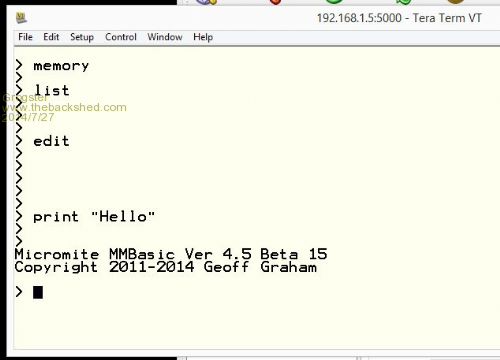

EDIT: Well, HALF working - uM keeps failing to respond after about 5 seconds of active use. I can make the link work again fine, if I cycle power to the uM module, but again, the connection only works for 5-10 seconds, then all I get are the > prompt characters and nothing else.
EDIT: I've changed the port number to 23 instead of 5000, as TT help was suggesting that port 23 should be used for Telnet stuff. Same result - talks OK for 5-10 seconds, then all I get are > prompts.
However, this DOES mean that the link is essentially working, and the uM is responding, but only with the prompt, so I guess there must still be some setting or timing issue that I need to find.
Another photo:
EDIT: I have disabled debug mode in the config tool for the 107, hoping that this might have been the problem.
From the manual:
If this mode is checked, you can monitor the status of module and socket message like
listen OK, connect fail etc. through serial terminal. If debug mode is on, debug message can cause abnormal operation of the serial device. Therefore, just use this mode only for debug mode.
Nice idea, but did not help at all. Edited by Grogster 2014-07-28
