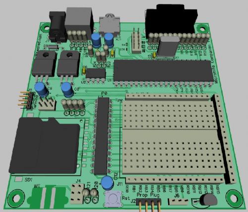

Our Micromite/Propeller combo project is about to get it's own board.
This project has a few features in common with the Maximite, but is based on the parallax Propeller since it's a micro we really enjoy fooling with.
The Wii and IR connections are tied to the Micromite by default.
http://propellerpowered.com/forum/index.php?topic=594.msg380 1
My Propeller/Micromite mini-computer project.

Looks good.
Atmel and Microchip working in harmony on the same board.
Who says you have to choose one or the other! (rhetorical!)
I am watching this project with interest.
I'm a little out of touch on the specifics, so will have to read up about it a bit more, but from what I remember, you are using the Propeller as a graphics(and sound?) controller, leaving the MicroMite to crunch the code.
I seem to recall you are using the uM as an editor, pretty much for Propeller code - is that right?
So, in other words: the uM becomes a Propeller code editor, and you don't really use the MMBASIC at all - correct?
...I may have that concept wrong - it would not be a first... Edited by Grogster 2014-07-25

Don't worry. I understand the confusion.. :)
The Propeller is actually a Parallax product. Once upon a time, there was a closer relationship between Microchip and Parallax, so that part isn't too unusual.
The Propeller is acting as a serial/console VT100 terminal for the Micromite, but also has additional I2C connections to provide extended graphics & sound capability controlled by the Micromite.
If all you do is switch it on, you've got a self-contained VT100 terminal controlled by the Micromite for running/editing BASIC programs, making it in charge. Additionally, using the Micromite's I2C commands, you can command the Propeller's extended graphics/audio commands from MMBASIC.
The part that leads to confusion is that you can also execute a Propeller binary, putting the Micromite in a "holding pattern" while you run Propeller code. I've included a mini Spin compiler which takes advantage of the Micromite's editor, then uses Propeller binaries to create other Propeller binaries. It would even be possible to have the Micromite then act as a slave (ADC,etc) for the Propeller passing it's data up the console connection.
The idea here is to provide as much of the power of both chips to the user.

Maybe not Atmel an Microchip on the same board afterall....
Apologies to Parallax fans out there - thanks for the clarification.
I am interested in this project, if you can command the advanced video and sound capabilities of the Propeller from within MMBASIC - that does indeed sound very attractive to us MMBASIC users.
I've just had another quick look at your vids on YouTube, but cos you are swapping between forth and spin files and other things so much, I got a little lost!
Still, I FULLY understand WHY you were doing that - to show how easy it is to do just that with your setup.
I'd love to see you show us here some demos of how you use the project and MMBASIC, to talk to the advanced features of the Propeller chip - I am quite sure others here at this forum would also be very interested in that.
However, you probably have enough on your plate as it is without that!!!!
