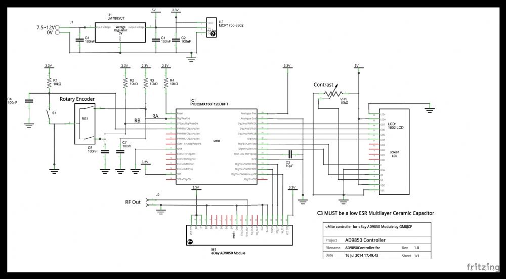

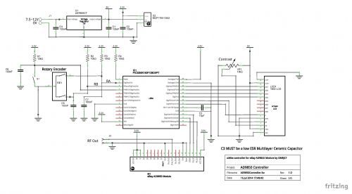

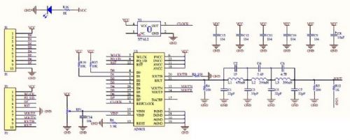

Here are the
1) Schematic of my set-up (my first time with Fritzing, so it doesn't look very pretty)
2) Schematic of the eBay module
3) Picture of the eBay module
Hope these help.
73
Peter

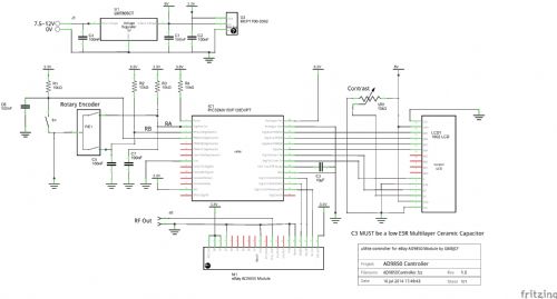

Here's a more readable (I think) version of the schematic.
73
Peter
The only Konstant is Change
G8JCF
Joined: 15/05/2014
Posts: 676
Posted: 01:36pm 16 Jul 2014
Sorry, posting JPG's doesn't seem too good !
So here's the picture as a GIF
If anybody wants the hires PDF or .FZZ just PM me with your email address and I'll send it directly to you.
73
Peter
