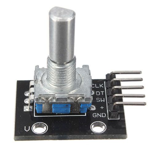

Hi
The KY040 Rotary Encoder module is widely available on eBay for less than US$2.00 inc P&P to UK, See Link
Anyway, here's some demonstrator software to show how to wire the KY040 up to a uMite and use it. The code is also available on MMReference.com Thanks David.
Hopefully this code will help more people to use Rotary Encoders with their uMites.
73
Peter
' Rotary Encoder (KY040) Demonstrator
' MMBasic 4.5 or newer.
' (c) Peter Carnegie 2014
' The KY040 module contains a rotary encoder together with a push-switch on a small
' PCB with 5 Connections. The KY040 was developed for Arduino, but of course us uMite
' folk can use it as well, and the KY040 is incredibly cheap, US$2.0 inc P&P, just
' search eBay for KY040.
' Wiring it up
' KY040 Micromite
' CLK 2 ---> 0.1uF ---> Ov
' DT 3 ---> 0.1uF ---> Ov
' SW 4 ---> 0.1uF ---> Ov
' + 3V3
' Gnd 0V
' NB
' 1) It is VERY important to decouple the DT,CLK & SW pins to 0V
' using 0.1uF at the uMite end of the link wire.
' If you don't decouple these signals, severe contact bounce will be evident,
' eg one click will generate a dozen or more increment/decrements.
' 2) The KY040 module has on-board pullup resistors. You must supply 3V3 or less
' to the + pin of the KY040 module
' 3) This s/w works fine with just a standalone rotary encoder, but you will need
' to supply your own 10K pullups to 3V3. For a standalone encoder RA=CLK, RB=DT, & SW=SW
' When this software runs, each CLOCKwise step of the rotary encoder will result
' in an increase of the variable DisplayValue which will be printed to the Console.
' Each ANTI-clockwise step of the rotary encoder will result in a decrease of the
' variable DisplayValue which will be printed to the Console.
' Pushing the push-switch will clear the variable DisplayValue to 0.
' This demonstration s/w is Interrupt based for maximum responsiveness.
' This software improves on the snippet listed
' in the Micromite User Manual in that the count, DisplayValue
' increases/decreases more smoothly/accurately.
'Declare all Global Variables here
'Rotary Encoder Input pins
DIM CLK,DT
CLK=2
DT=3
'Push Switch Input Pin
DIM SW
SW=4
'Configure uMite pins
SETPIN DT, DIN
SETPIN CLK, INTH, REInt
SETPIN SW, INTH, SWInt
'Variable incremented/decremented by the Interrupt handling
'routine for the Rotary Encoder.Needs to be global so that
'REInt ISR can access it
DIM Value
'Var Display Value Inc/Decremented in Main Loop
'Cleared when Switch is pushed.Needs to be Global so that
'SWInt ISR can access it
DIM DispValue
'Set to 1 to request a refresh of the display.Needs to be Global so that
DIM DisplayRefresh
'Go run the Program
Main
END
SUB Main
LOCAL LastValue
LOCAL Change
'The Main Program Loop
DO
'Has there been any movement of the encoder ?
Change=Value-LastValue
'We've caught the change so prepare for next time round
LastValue=Value
'Was there any movement of the encoder ?
IF Change<>0 THEN
'If encoder is turning ANTI-clockwise, Decrement
IF Change<0 THEN
DispValue=DispValue-1
ENDIF
'If encoder is turning CLOCKwise, Increment
IF Change>0 THEN
DispValue=DispValue+1
ENDIF
'Request a Display Refresh
DisplayRefresh=1
ENDIF
'Update the Display ?
IF DisplayRefresh=1 THEN
'Reset the trigger
DisplayRefresh=0
'Display on the Console
PRINT STR$(DispValue)
ENDIF
LOOP
END SUB
'ISR for Rotary Encoder
'Here when the Rotary encoder moves
SUB REInt()
IF PIN(DT)=1 THEN
'Clockwise rotation
Value=Value+1
ELSE
'Anti-Clockwise rotation
Value=Value-1
ENDIF
END SUB
'ISR for Push-Switch
'Here when Switch changes state
SUB SWInt()
'Clear the Displayed Value
DispValue=0
'And trigger a DisplayRefresh of DispValue
DisplayRefresh=1
END SUB

G8JCF
Joined: 15/05/2014
Posts: 676
Posted: 06:05am 13 Jul 2014
@boss
I pasted your source into MMEdit, but line 218 says Cy=0, and also the step sizes in the code you posted seem to be the same as the original, ie
'Array of Possible Step Sizes in Hz
Dim StepHz(4)
StepHz(0)=1
StepHz(1)=10
StepHz(2)=100
StepHz(3)=1000
If you need larger step sizes then proceed as follows
1) Increase the size of the StepHz array, eg
Dim StepHz(6)
StepHz(0)=1
StepHz(1)=10
StepHz(2)=100
StepHz(3)=1000
StepHz(4)=10000
StepHZ(5)=100000
2) Increase the number of Step Tuning Words, eg
'What to Add/Subtract from the Scaled tuning Word
'for each Encoder Up/Down
Dim StepTWord$(6) Length 24
'These TuningWord sizes were calculated using Double precision arithmetic
'in VB6, using 2^32/125.0
StepTWord$(0)="34359738" '1Hz 34359738.368
StepTWord$(1)="343597384" '10Hz 343597383.68
StepTWord$(2)="3435973837" '100Hz 3435973836.8
StepTWord$(3)="34359738368" '1000Hz 34359738368
StepTWord$(4)="343597383680" '10000Hz 343597383680
StepTWord$(5)="3435973836800" '100000Hz 3435973836800
3) In SUB StepChange make the modification to accommodate the extra step sizes, eg
Sub StepChange
CurStepIndex=CurStepIndex+1
'Roll round CurStepIndex if greater than 5
CurStepIndex=CurStepIndex Mod 6
'Load the CurStepTW with the Step in TW
LoadBCD CurStepTW(0),StepTWord$(CurStepIndex)
'Could display something on the LCD to indicate New Step in force
'eg Underline digit.
$) Also you could change - simply for neatness
line 98 SETPIN RSW, INTL, Roll
TO
Line 98 SETPIN RSW, INTL, StepChange
and delete
Roll:
StepCHANGE
IRETURN
Did U try the Gearing/Ratio suggestion in my last post ?
That should do it, the frequency should never be longer than 8 digits when using an AD9850, the highest frequency the AD9850 can generate with a 125 MHz clock is 125/2=62.5 MHz clock, and with these eBay modules anything above 30 MHz is not really worth using.
Unfortunately I've partially dismantled my AD9850Controller setup, so I can't test the code right now. But, as soon as I get the chance I will reassemble the test-rig and check out larger step-sizes.
OK ?
Peter
The only Konstant is Change
G8JCF
Joined: 15/05/2014
Posts: 676
Posted: 06:25am 13 Jul 2014
@boss
I found a bug with 100,000 Hz step change when decrementing the frequency which gives rise to the error message you reported. I will have to take a look, and hopefully will be able to send out a fix soon.
Thanks for helping debug the code
