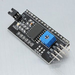

I received the I2C to LCD adaptor on Saturday and have coded up a useful library to make using LCD over I2C using this module as similar as possible to the native parallel LCD commands in MMBasic. What is remarkable is the low price, 99p/US$1.6 including P&P to the UK !
I2C to LCD I/F
The reduction in wiring is tremendous and most definitely worth 99p. I will be converting my AD9850Controller software over to using this LCDI2C library.
Hope someone finds this useful.

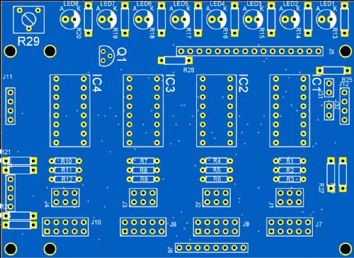

Maybe its time to announce a new PCB that I have been working on, in conjunction with HallDave and Don,
It uses 4 of these chips (which are available for about 50c each) and each have their own, addressable, I2C address.. so a total of 4 I2C addresses on the same board.
The Board is designed to bolt onto the back of a 20x4 or 16x4 LCD and has the following `standard' interfaces. And the boards can be cascaded.
IC1 LCD
IC2 KeyPad 4x4
IC3 8 way LED driver
IC4 General IO expansion for users Choice
Each PCF8574 comes out to a 10way header with the 8 IO plus GND and 5v (or 3v3 but an LCD need 5v generally) so if you dont want to use the LEDs or other port then you still have access to the IO for other uses..
I am now in the final stages. I am in the tracking and Via minimisation process at the moment.
Here is the overlay as it currently stands
Note the `flea holes' you can see are the vias (I can't seem to turn them off in the view mode without turning the PADs off as well) it is 98mm x 71.4mm approx
The LEDS are designed to mount on the backside of the PCB (I havent swapped the overlay to there yet) so that they are directly above the LCD.
This board came about as a consequence for another PCB I am desgning, in conjunction with Dave and Don, which I wont announce just yet but is a plug-in for my MuP uMITE PCB,
Edited by bigmik 2014-07-09

Hi Mick
Looks very promising and all PTH so easy to solder :)
I take it that J5 is a direct match for the standard LCD 16 way connector, and that Q1 is for the backlight control ?
Will this new module fit within the boundaries of a 1602/2002 display ?
Eagerly looking forward to when you have something for sale, bare PCB/fully loaded.

Posted: 02:42pm 08 Jul 2014
Hi Peter, All,
In the design process, I looked at the 16x2 and 20x2 mounting holes.
The 16x2 has the pin 1 of the display 8mm from the edge whilst the 16x4 and 20x4 are 10mm from the edge, so mounting holes would overlap... not satisfactory.. so I decided to ignore them, also the 20x2 had a different dual row on the side and was not really usable..
That aside the 16x2 will electrically work and you wont need to screw it down a bit of double sided tape (thicker 3mm stuff) built-up to make sure that the metal work wont short anything on the rear side.. Will be covered in the accompanying manual when it is available..
MICK

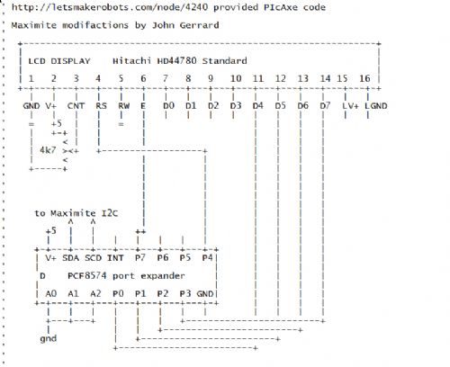

Also, what connections have you configured for the PCF8574 to LCD ? Hopefully as per my code !!
Uses PCF8574 - 8 bit I2C Port Expander
I2CAddress is &H27 with unjumpered address pads
PCF8574 port is wired as follows
P0 - RS
P1 - RW
P2 - EN
P3 - Backlight On/Off
P4 - D4 LCD
P5 - D5 LCD
P6 - D6 LCD
P7 - D7 LCD
Anyway, please let us know when your board will be available.

As you will find when you buy other `brands' of the module you used, there is NO standard, some are close but others are totally different.
I used the pinout as John Gerrard did in his I2C sample..
As, at the time it was the only working example of a working I2C LCD..
Yours is totally different..
Of course this only needs code to be modified to suit.
I am not much of a coder so hopefully you can specify each pins connection at the start of the program to allow any derivative to be used.
EDIT **** Sorry the code didnt paste well here is a screen dump

Designing this PCB has been quite enlightening and I have become very excited by this little chip So I will share a little of what I have learned as it may be useful to others.
There are at least two versions of this Chip the 8574 and the 8574a (may only be the NXP brand) The 8574 has 8 possible addresses from 20H-27H the 8574a has 8 from 38H-3FH
This device can drive LEDs directly (through appropriate current limiting resistors) BUT drive them with a LOW from the output and the ANODE of the LED connected to Vcc else you will need pull-up resistors to get them to drive properly.
The chip is bi-directional and you do not need to tell the chip whether you are reading or writing (No R/W pin)
To read a bit from the port, first set the bit high by writing to it and then read back its status.
The chip has an INT output that goes low whenever the state of pin (previously SET high) changes state.. This can be used by your micro to trigger an interrupt to let you know something has changed.. Can save polling for say a Keypad.
Hope that is helpful information for someone.

I am really excited about this board
Two boards cascaded gives you 64 io's
Use 1 for LCD
1 for 4x4 keypad
You have 8 LEDs to drive individually
And then a further 5 x 8 io ports for rtc or flash ram etc
Made out of very cheap easy to construct for any newbie parts
And the micromite will have all those free ports, also would work for raspberry ip and arduino
I cannot find anything out in the internet with this much io extension
Wow
I can't wait to use it
David
