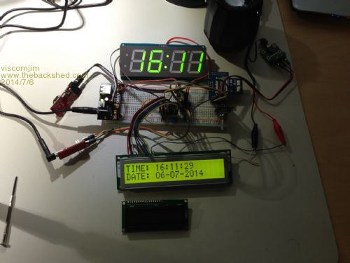

Just a quick project...
Friend wanted clock with Tibetan bells on certain time markers. Here is uMite with adafruit 7 segment LED 1.2" display (I2C), olimex mod rtc (will be switching to ds3231 for better accuracy), MDfly mp3 module for sound, serial connection, single encoder with push button for menu, time, sound, volume, etc. settings. The large lcd will not be part of this project, I just wanted to show this as it is a great deal from Jameco or Ebay. It is an extra large 2002 display for about $5.00 ea. The lcd below it is a 1602 for size comparison. Could be good for a few projects, especially at that price.
Just having some fun with uMite. Thanks again Geoff and forum members for all your help once again!
