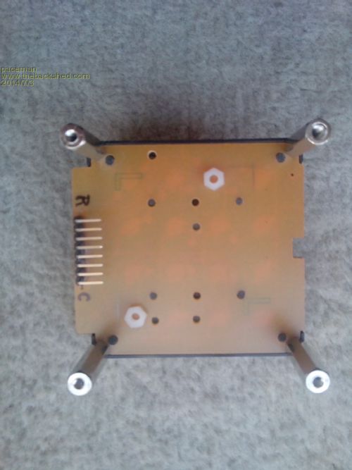

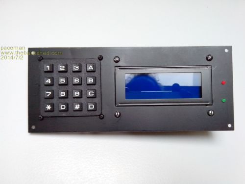

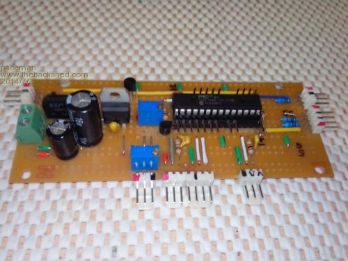

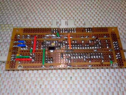

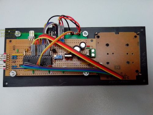

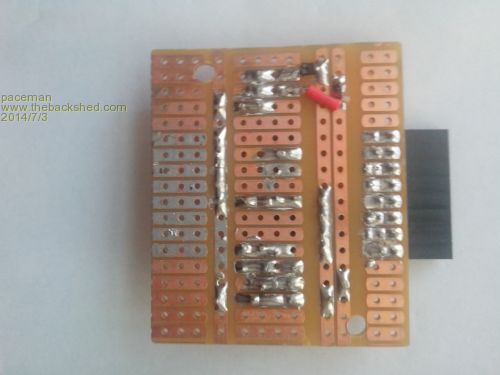

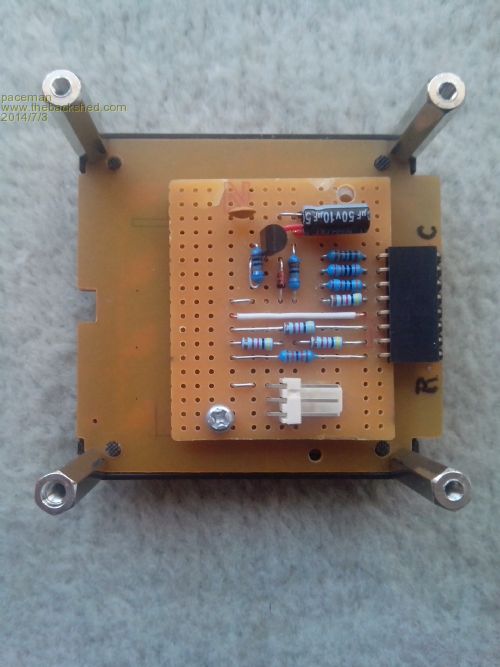

  G8JCF said   I want to switch the LCD drive from 4 bit parallel to I2C, so I've ordered some I2C to LCD modules ...... I want to add a keypad hence why I need to reduce the amount of I/O lines used for the LCD, and also, I need 3 ADC channels for measuring SWR, and Reactance. Also only having to take 4 wires to the front-panel instead of 9 for the LCD makes for a much tidier/easier assembly.
Peter
I've recently built a MicroMite UV exposure box timer on some proto board using a parallel display and parallel 4x4 keypad and it's quite a squeeze wiring it up. See below:
The keypad pin usage (seven lines or eight for a 4x4 pad) is worse than for the parallel display. That can be cut to one though if you use the single analogue input method for the keypad. There's a thread on the forum for that and it works well. It's an even bigger pain running the parallel keypad lines to the panel than it is for the display so using an I2C display and single line analogue keypad seems to me a very neat way of doing it and very economical on pin use. You can also use the 'spare' keys (* and #) for brightness control via PWM or with a 4x4 keypad control other functions.
Even so, using a parallel 20x4 display and parallel 4x4 keypad I managed to also get the PWM display brightness control, lamp relay control (opto isolated), lamp 'ON' LED and a buzzer all controlled by the 24 pin chip and with two pins left over. Provision was also made on the board for the console Tx/Rx and ICSP connector (with some shared pins) but it all works. This is what the proto board looks like (actually it's half a proto board). I confess that I did use a couple of surface mounts bits to squeeze things in and the bottom as well as the top of the board was used, e.g. the 3.3v reg on the bottom.
Greg

Joined: 15/05/2014
Posts: 676
Posted: 05:45am 02 Jul 2014
That's impressive Greg, and SMD on stripboard !
Thanks for the tip about using an analogue input for the keypad, I'll search the Backshed and see if I can find that thread, much appreciated.
Very many thanks
Peter
