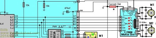

Posted: 01:46am 11 Jun 2014
These modules from DX.com will drive two motors up to 2A.
The description is fro stepper motors but they drive two independent motors.
Connect the PWM to the EN inputs.
http://www.dx.com/p/l298n-dual-h-bridge-dc-motor-driver-for- robot-smart-car-green-154444#.U5hBQ7mKBhE
