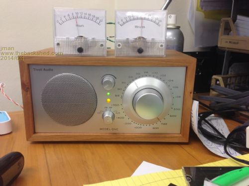

Hi All

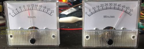

Thought I would post my meter clock in case anybody else wanted to make one
The images are a little fuzzy (TBS resize issue)

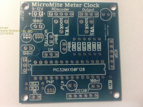

The PCB below is the version without the 5V regulator and PWM backlight

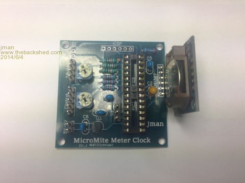

The PCB below is the version with the 5V regulator and PWM backlight
I have attached the circuit diagram, gerbers, meter scales and Micromite source should you wish to make your own.
I have a couple of both types of PCB should anybody want one unfortunately the both contain an error that requires a track to be cut a wire link to be added.
I will do this should anybody want one.
Meters were sourced on Ebay http://www.ebay.com/itm/271365409590?var=570246171842&ssPage Name=STRK:MEWNX:IT&_trksid=p3984.m1439.l2649
RTC Module also sourced on Ebay http://www.ebay.com/itm/ARM-RTC-I2C-DS1307-AT24C32-Real-Time -Clock-Module-2-8CM-x-2-7CM-/301141332978?pt=LH_DefaultDomai n_0&hash=item461d6c13f2
Basic operation as below
On first power up the meters will sweep from 0 to full twice
If the DS1307 has not had the time set before the seconds LED (D1) will be on.
To set the time press and hold the rotary decoder switch down for more than 3 seconds
This will allow the time to be set using the rotary encoder a second press of the rotary encoder button will set the minutes a third press
will save the time to the DS1307 and D1 will start to flash a 1 Hz
A short press of the rotary encoder button will allow the backlight brightness to be set using the rotary encoder in this mode a second press saves the brightness level to eeprom. If the power is lost the clock will get the time from the DS1307 and the brightness level from the eeprom.
The backlights are diffused LED’s of your colour choice these are fitted to the meters by drilling two appropriately sized holes (3mm or 5mm) at the bottom (two required) of the two meters.
The meter scales were done using MeterBasic from here http://www.tonnesoftware.com/meterbasicdownload2.html
The clock is powered by a DC source 7.5-12VDC 100ma is more than adequate
U3 is to set theDS1307 modules supply voltage Jumper on 1-2 is for 5V and 2-3 is for 3.3v Most will require 5v
Q1 is any general purpose PNP transistor
The rotary encoder connections are (1-2 switch) ( 3 common 4 is left and 5 is right)
Meter connections are 1-2 Minutes 3-4 Hours
The current PWM percentage and time is updated once minute and can be monitored via the serial port
If the brightness is adjusted this can also be monitored via the serial port.

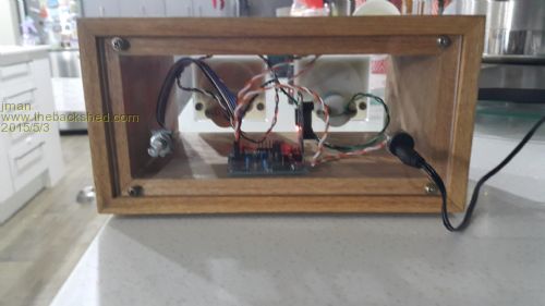

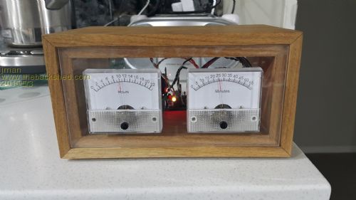

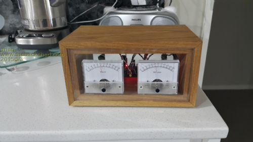

Posted: 03:36pm 02 May 2015
So I finally put in a box that matches my Radio
Jman
