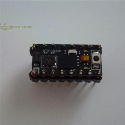

Some preliminary information that might be of interest to you.
A 16-pin DIP module:
http://dimitech.com/downloads/dtx1-4400p.pdf
It will be very good price as well (think large pizza for example).
The software will be an integrated shell like the mites but much more extended and closer to a unix machine with internal flash media like the A: drive. Currently in development, hopefully available in less than a month.

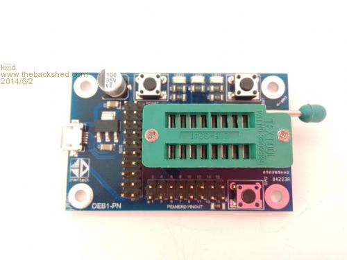

Devboard for it:
http://dimitech.com/downloads/deb1-pn_circuit.pdf
So there will be smaller DIP packages soon, although not exactly micromites Edited by kiiid 2014-06-03
