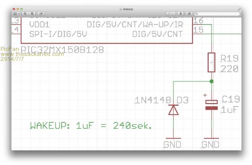

I have tried the following and it works well. 220 ohms in series to a 1uF tantalum capacitor. Anti-parallel to the capacitor, a diode 1N4148. The leakage current of the diode compensates the leakage current of the uP Pin. Delay: 1uF = 240 sek.

Hi PicFan,
Have you got a schematic (even a photo of a sketch) as I am a bit confused as to how this is hooked up?
What do you mean by ANTI-PARALLEL? Do you mean reverse BIASED?

Posted: 11:38pm 06 Jul 2014
Hi bigmik,
Best regards from Austria - Tirol !
Wolfgang
Posted: 12:47am 07 Jul 2014
Perfect,
Thanks Wolfgang,
I understand what you mean now.
