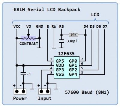

As I was porting (from C AVR) a better one_wire library than Jallib actually has (the current one offers basic functionality, unable to sense all the changes on the bus) and, because I recently tested an 2x16 LCD in 4bit mode, I thought that maybe there is one_wire LCD library somewhere on the net. It is fantastic what I found if it will work:
@McLaren (Mike) from DangerousPrototypes.com came with one 8pin microcontroller as one wire driver for an LCD. In fact, it had nothing to do with the one_wire protocol, it was just "physically identical".
On the forum's thread you can download the sources. I know that there are also solutions based on shift registers but this one is very nice.

The TX pin from your microcontroller must be hook up to the GP3 pin of PIC12F635 and the comm. speed seems to be 57600 bps! Yes, serial, but still one pin .

  vasi said   The TX pin from your microcontroller must be hook up to the GP3 pin of PIC12F635 and the comm. speed seems to be 57600 bps! Yes, serial, but still one pin .
Looks like a better option than the cheap I2C Backpacks via Ebay. I can live with 57600 bps.
The Diagram shows a PIC12F635, however the code supplied on the link is for PIC12F683. But probably not too hard to port to PIC12F635.
I happen to have several spare PIC12F683s (Picaxe 08M), so I will "re-purpose" one of these and see how it works out.

Posted: 06:56am 23 May 2014
Qualified success.
Upon initialization the display showed several characters of garbage. But accepts characters. It displays "Hello" after the garbage. It will not accept command data.
The scope showed RS not staying high long enough. So the CAP was changed to 1nf and it seems to work OK now.
By looking at the scope, it seems that the cap is being charged by two 5us pulses. With a 330p Cap there is a dip to zero in the middle of the signal on RS.
Increasing the cap to 1nF reduces the dip to an acceptable level. Now there is no garbage, & I can send 0xFE, 0x01 to clear the screen.
This is a Newhaven display with a ST7066U Controller.
Could it be that the loading on the RS pin varies between driver chips?
Looks very good, but needs some further testing before I'd say all is well.

Hi Bill,
Thank you for your qualified testings. Yes, I have three 2x16 LCDs which required different timings for initialization.
Exactly your controller!!!. So for me is great to know this (I will include the both capacitors and select them with a jumper).
BTW, using ATmegas with a general LCD library it worked from the first try (it seems that they included all the necessary timings for all the LCD controllers).

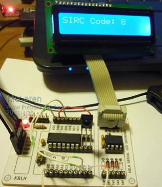

I'd love to see pictures of how you guys implemented this little backpack design. I didn't do much with it except to put it on a little 8-14-20 pin development board (picture below).
