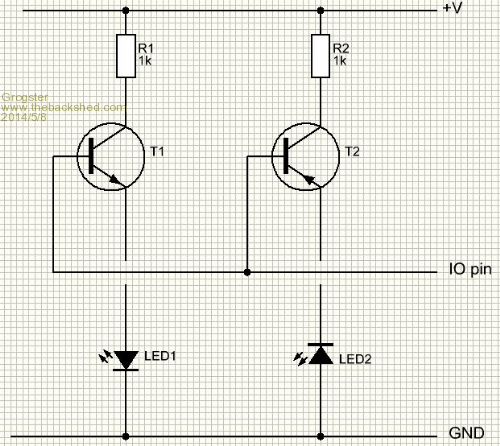

Posted: 01:28am 08 May 2014
I guess you mean something like this?
That would certainly work for two LED's on one IO pin.
If you make the IO pin connected to the two bases an input, I would expect that this would turn off both LED's.
Come to think of it, it probably won't, as there are internal 10k pullups inside the PIC I think. If that is the case, even as an input, the pin will be high, which would keep one of the LED's on. I would have to build it on the bench to test it out, but it is possible that it could work.

Posted: 01:44am 08 May 2014
Groggy,
Not quite.. You will never get led2 to light as +ve needs to go to the anode, which you connected to gnd..
But the general idea is correct... I will do a cct for you if i get a chance tomorrow..
As for turning on one led when set as an input that is why the divider is to bias both off..
I need to think a bit more myself, i am not in that frame of mind at the moment..

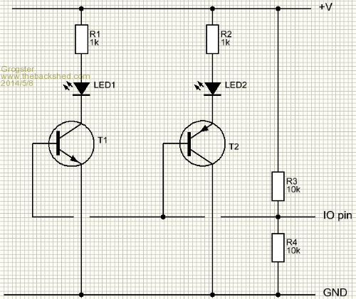

Posted: 02:08am 08 May 2014
How about this?
I am still not sure about the bases of the transistors in this arrangement....
Oh well - does not matter to me really, you have just made me curious Mick!!!!
See ya'all tomorrow - midnight or so here, and the Grogster needs sleep. Edited by Grogster 2014-05-09

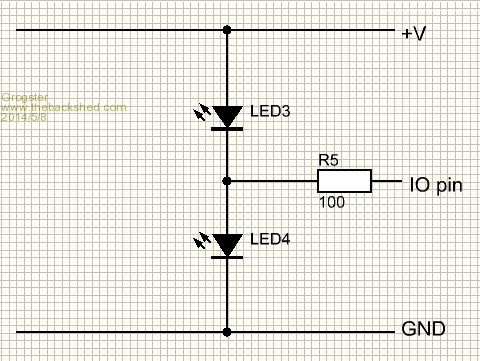

Posted: 02:10am 08 May 2014
Grogs,
Actually thinking about this, if you use high intensity leds with a fwd voltage drop of 2.2v or so,
Put them in series and connect the loose anode to 3.3v and the loose cathode to gnd then connect your io pin to the junction via a 100R resistor that might be all you need.. As the max voltage you could get across is 3.3/2 or 1.65 volt when the io is input i reckon no Led will light.
Drop the Resistor to about 22R when 5 Leds in parallel,.. Maybe have to trial resistor values,
Posted: 02:15am 08 May 2014
Ahhhhhhh - you mean like this:
If the IO pin is an output, and is high, LED4 will light, but LED3 will be reverse-biased, so will remain off.
If the IO pin is an output, and is low, LED3 will light, but LED4 will be reverse-biased, so will remain off.
If the IO pin is an input, there is insufficient voltage on the input pin to forward-bias either LED, so they are both off.
I will try this tomorrow on the breadboard.... Edited by Grogster 2014-05-09
