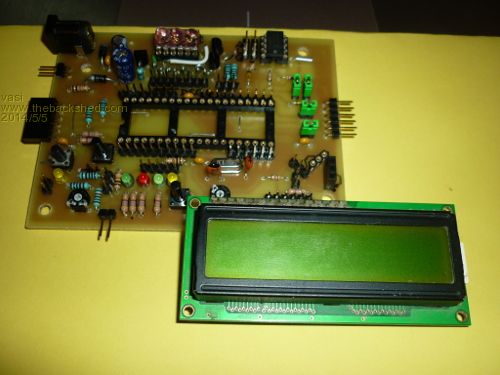

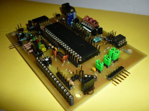

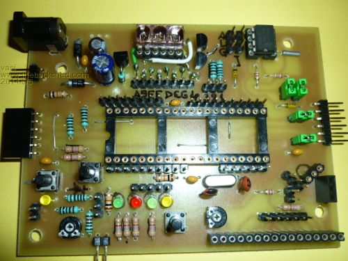

It is a home made 100x75 mm single-sided development board designed to put the PIC18F46K22 on a trial to see how it behaves compared to a Sanguino board. It is still on a "almost ready" state but can be used as it is. I chose to have it instead of a "Sanguino breadboard" style board which, together with a big breadboard would have occupied a lot of space on my small office.
It is still missing a 7805 regulator (it powers from USB-to-Serial adapter), a 5v1 Zener diode protection for a resistive divider (measuring up to +55Vcc but is ok if I don't get close to the maximum voltage) and those two trimpots are just for show (not soldered) as they are 100K instead of 10K - one is for testing the ADC, the other is for LCD contrast.

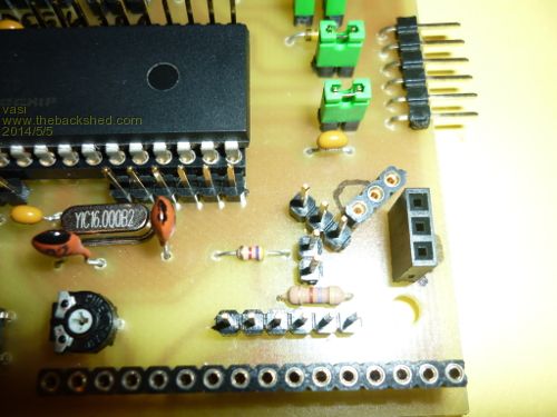

It has a PCF8583 as RTC (not tested yet) with two jumpers for 4k7 pull-up resistors and a smd battery socket bellow the board, a serial connection (Arduino standard) with a jumper on VCC and the another on the automatic reset function (which is not used by the actual bootloader, a modified AN1310 serial bootloader who needs a button to enter in boot mode):
The taller 3pin female connector (Arduino socket style) is to accommodate an interchangeable IR decoder (for 36, 38 or 40 KHz) and the smaller 3pin female connector is for a Dallas temperature sensor. The longer female connector is for 16x2 LCD display:

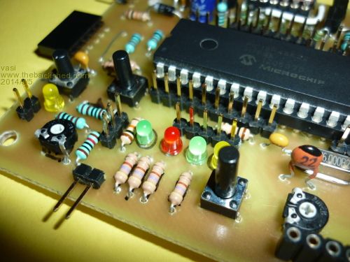

There are 2 user buttons, 4 user LEDs, a trimpot for ADC testing, a resistive divider for measuring external voltages, an ICSP connector (the black horizontal 6pin female connector):

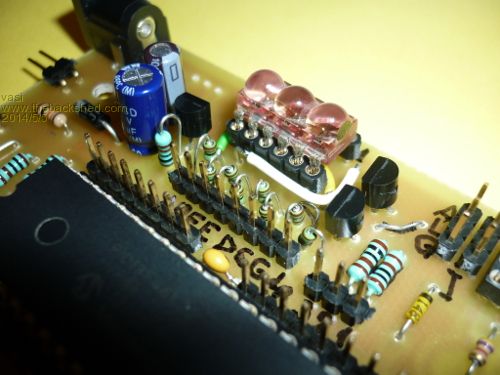

12 years ago I recovered from a vintage computer board this Bubble Display (3 digits 7 segment) which I had no immediate use for it (not even curious to see the pinout), with the code "HP 5082 7433" It was hard to fit into such a small space and a single-sided design but now is ready to be stressed (datasheet here - and here, you can find a 4 digits one on ebay):
Until now, I've tested only the bootloader and did a blink a LED test. Personally, I'm not happy with the final result. Originally, the board was 100x80 mm (the maximum on Eagle Lite) then I had to resize it to 100x75 mm because it was what I had available, then I had to move the peripherals around to make space for the Bubble Display which was a last minute addition (remembered that I had it and I thought it would make a better impression than a single, regular 7seg. digit).

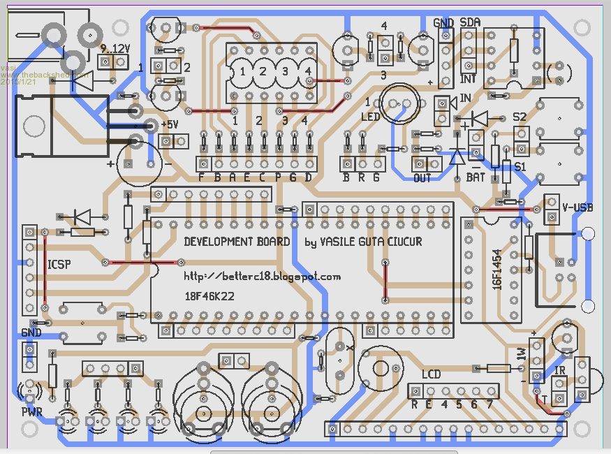

Anyway, this is the initial Eagle project, before starting to fit the Bubble Display. I will start from this project again in the future, to redo the board, trying to make it much prettier and maybe adding some more peripherals... But not so soon.

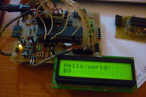

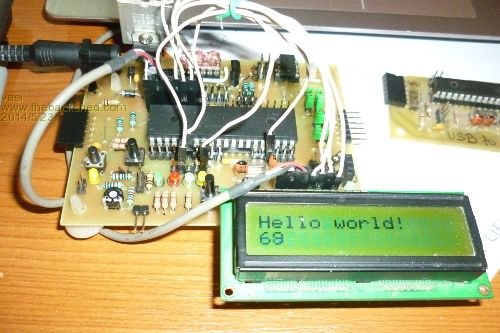

Posted: 06:09pm 22 May 2014
Pretty messy, but it works. It is a JAL LCD example which come with the standard Jallib package.

And my board may look like this at some point in the future...
And it may include:
- 1x4digit bubble display,
- 1 2x16 LCD
- 1 RGB LED
- 1 PCF8583 (external battery)
- 1 I2C bus
- 1 1wire bus
- 1 DS18B20
- 1 IR receiver (36,38,40KHz)
- 4 LEDs
- 2 user buttons
- 2 10K pots
- 1 resistive divider for real life voltage measurement
- 1 USB_to_Serial with PIC16F1454
But until then, I'm using my actual board, and some of the C code is available on googlecode.com. Actually, on github now.Edited by vasi 2015-12-20
