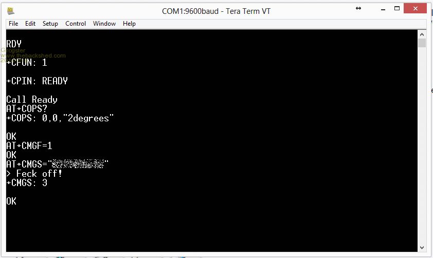

Image of how simple it is to get things going: (this is from power-up)
Cellphone number to send to, has been "Altered" by my picture software, for privacy...

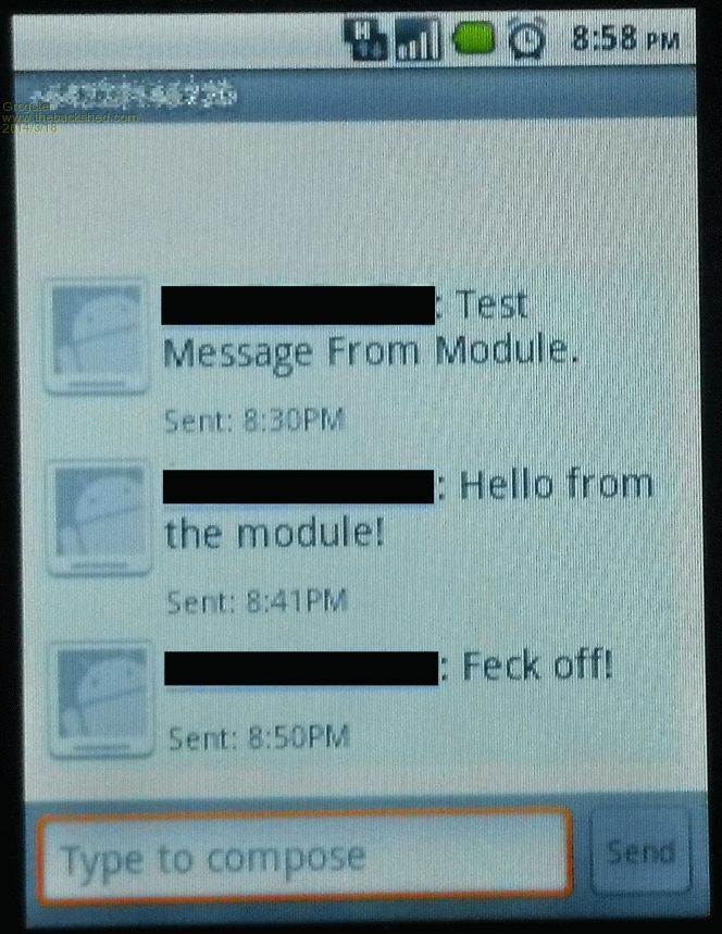

And the results on the cellphone...(number blacked out for privacy, but previous two messages shown)

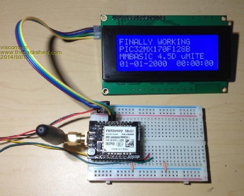

Hi Grogster, glad to see you got your freak unit working. It is a nice unit and relatively easy to make it work with the uMite. I am getting ready to play with this one...
It is really small, about the size of an XBEE module. The cool thing about this board is that it has a pic32mx170f256b in a qfn package already on it. It works with MMBasic as you can see here. I had an issue with the first board with the gsm module, but the pic and the I2C worked hence the display. I just received my new board and will start playing with the gsm hopefully in the next day or two.

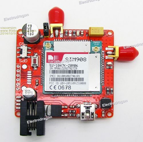

Hi Grogster, check out this bad boy. GPS and SMS all in one. SIM908. I WANT!!!!

FleaBay has lots - but are these gonna be 'Power Hungry' do you think?

Hi White, I haven't looked at the specs too closely, but I would imagine it draws a bit of power.

This iteadstudio one itead SIM908 pulls 500mA continuous and 2A pulse - urkk!
