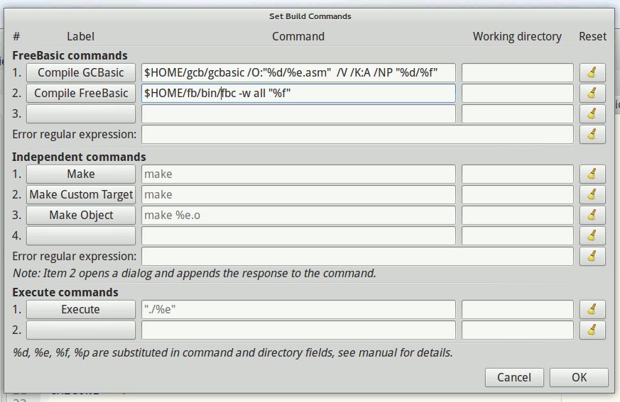

You set the building commands like this

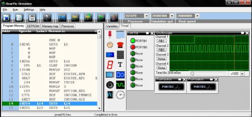

You can also install the low cost Real PIC Simulator and the links are already setup.
Real PIC Simulator allows you to debug your project with simulated hardware and step through the assembly code and run to breakpoints.
Or import the assembly file into MPLAB and simulate there.
Real PIC Simulator is $29 but the rest is free.
Real PIC Simulator Screen Shot
