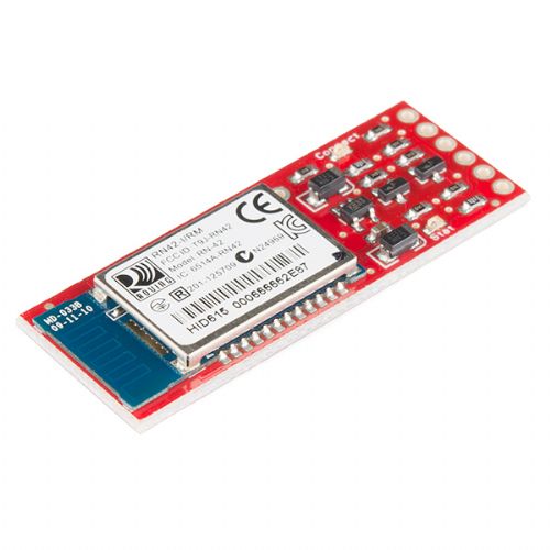

I use this little bluetooth module, it works with any microcontroller who have serial peripheral.
https://www.sparkfun.com/products/12576
A PC with bluetooth will recognize it as a serial port and then is easy to communicate with the microcontroller. It covers a distance of 10 meters but there is a device who can cover 100 meters.
I find it expensive if you intend to equip with it every "satellite" who is part of your home automation (and who is reporting back to your PC or mobile device), but as a single device for development is great.
