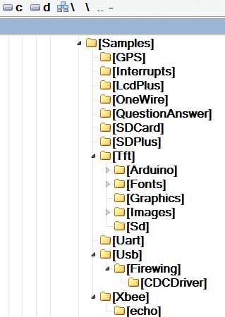

Dietmar, just look for some samples for PIC24 - look inside
c:\ProgramData\Mecanique\Firewing\Samples\ if you have Win7 or bigger.
You should just change the device, adapt the sample to your pins (start with a LED blink) and you should be able to compile. Everything I know now are by browsing the Wiki, the forum, and Firewing folders.
As a last resort, forums are always open (this thing will increase in popularity).Edited by vasi 2014-03-16
