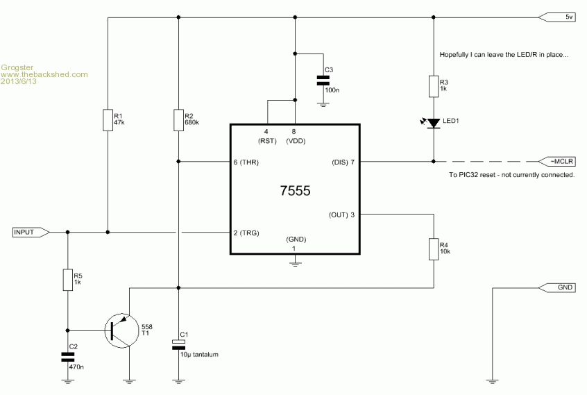

I just need to revive this thread for a few more posts, as I am now playing around with the watchdog reset idea for the MM.
I built the 555 missing pulse detector linked to by centrex, and although it works very well indeed, I have found one really major issue with it, so I want to run it past the rest of you for ideas.
The problem with this circuit, is that on initial power-up, the 555 output is low, meaning that if connected to the MM, at power up, the 555 circuit will hold the MM reset line low, the PIC32 will never start-up, and the MMBASIC code will not run to be able to start sending pulses to the 555 circuit in the first place.
See what I mean?
Once I start manually pulsing the input to the 555 circuit, the 555 output goes high as expected, and provided I keep pulsing the input, it stays high. With my experimental R/C combination of 560K/10uF, once I stop pulsing the input, about 6 seconds later, the 555 output goes low. Start pulsing the input again, and the 555 output goes high again and stays that way while I keep pulsing the input.
That is all GREAT, and EXACTLY how I wanted it, but the initial power-up problem with this circuit still remains, in that if actually connected to the PIC32, the 555 will pull the PIC32's reset line low, and keep it there until the 555 input starts pulsing. However, as the PIC32 is held in reset like this, it never starts up, the code never runs, so the pulses never start, and the MM stays in a state of electronic limbo forever!
Does anyone have any ideas on how to stop that?
I KNOW I can do this with a PICAXE 08 chip no worries, as you can program the PICAXE to wait for a few seconds at power up BEFORE it starts looking for input pulses.
...but I liked the idea of NOT using an MCU-based watchdog, to eliminate issues with the watchdog leading to the "Blind leading the blind" as mentioned earlier in this thread by MOBI...
Come to think of it, this 555 circuit has the exact same problem when it DOES reset a running PIC32, as it holds the PIC32 reset line low when tripped, instead of a pulse on the PIC32 reset line, which is what we really need...
I think I will have a play around with the PICAXE method, but I would still love to hear other members' input - it could be a simple enough fix. Edited by Grogster 2013-06-10

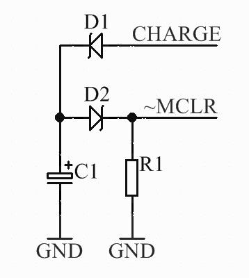

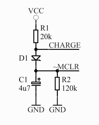

This is just an idea for you.
You can actually build a missing pulse detector in a much easier way. All microcontrollers have Schmitt triggers on their reset input (at least PICs certainly have) and you can use it by adding a simple RC circuit outside. Additionally you don't need to generate the external reset pulse on power up event as it is internally generated by the PIC.
See the picture.
You drive the 'CHARGE' from an output of the PIC, periodically charging the capacitor, which then slowly discharges itself through a resistor and feeds the '~MCLR' input of the PIC. When the voltage gets under the reset threshold as per the datasheet, the PIC will reset itself. So you have to periodically recharge the capacitor by sending a short pulse to it, to keep the micro from resetting. The values of the resistor and the capacitor can define the maximum reset period.

I will try this out, but I think we would still have the same issue, would we not, in that at power-up, the reset(~MCLR) line will be held low by R1 in your diagram, so the PIC never actually starts running.
Yes?
No?
I will set this up on the breadboard and try it out with LED's.
Thanks for posting and for the diagram - I will let you know what happens.

Posted: 08:03pm 08 Jun 2013
That could be a problem unless R1 is a value high enough (I think there was an internal pull-up on the MCLR input).
But that potential issue could be easily solved by adding a pull-up resistor on the 'CHARGE' line (before the diode!). Thus it will provide the initial charging for the capacitor and later on it won't matter because you will be holding the line low by the output unless charging.
This one should be fine in all cases. In fact you may not need D2 at all. I put it there only to neutralise the effect of the internal pull-up, but it is very small anyway.
With these values it should give you a nice window of about 0.5s to recharge.
Edited by kiiid 2013-06-10

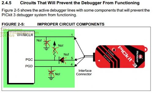

Posted: 10:49pm 08 Jun 2013
You still need to follow these pic programming rules when you want to be able to program the pic.
Make sure you can take that capacitor and maybe other parts that interfere out of the circuit by jumpers or switches when it is time to program.
And in case you missed its discussion see here: forum post , Geoff is thinking about adding a WATCHDOG command to MMBasic that uses the internal pic32 watchdog removing the need for extra circuitry.Edited by TZAdvantage 2013-06-10

If the capacitor is temporarily disconnected (let say through a jumper), there is absolutely no issues with the programming.
Adding an internal watchdog command I think is not 42. I have personally seen microcontrollers stuck so much that the internal watchdog is stuck as well.

  kiiid said   If the capacitor is temporarily disconnected (let say through a jumper), there is absolutely no issues with the programming.
Well that is what i noted in my post, because you did not when posting that circuit. It would introduce problems with programming when made like that circuit.
What happens when the mcu gets stuck and the charge line stays high?
Therefore the circuit you provided is just the wrong way to do it.
A good watchdog responds to a pulse not to a logic level.
A simple RC circuit is never going to work properly as a watchdog.
I also have seen microcontrollers not responding on a reset signal but only came back alive when first the power was removed.
Maybe a watchdog that monitors a watchdog which monitors a watchdog which monitors a watchdog which removes the power and that is monitored by a watchdog......
The internal watchdog is used all the time and almost everywhere. Unless it is some medical equipment you can trust the workings of the internal watchdog.
For extra security you can add a supervisory chip that monitors the power.
Power (voltage) monitoring is not a watchdogs task.
If power is browning out or is dirty a microcontroller can get into a unknown state . For that you can complement it with a supervisory chip like the MCP120 that will reset the microcontroller and hold it into reset until power is good again.
If the environment is electrically dirty, putting a metal cap over the circuit helps too. But if you are busy in such environments you would probably know what to do.
EMF/RF is also not a task of a watchdog, it is the concern of the designer to protect the circuit in the first place.Edited by TZAdvantage 2013-06-10

Well, there is no universal solution, you know that. The guy wanted ideas and I gave him one. That's it.
Actually the problem you cited (the micro stuck with its port in high) can be easily solved by adding a second capacitor in the circuit, but that is already way down the road.
I admit the internal watchdog in is many cases enough, unless you are doing something very special, but I think this whole topic started with the word "external..."Edited by kiiid 2013-06-10
