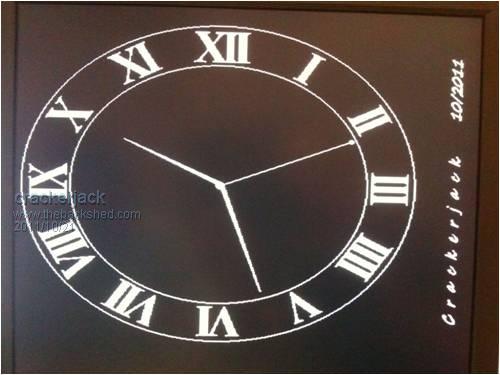

Photo of the VGA screen:

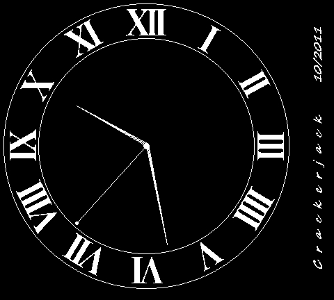

Screenshot using the SAVEBMP command:
The Maximite is never going to be an Apple-killing graphics work station, but some nice little effects can be obtained - and hey, it's so much fun...
I guess gauges and backgrounds of all sorts could be preloaded and then actual measured data displayed within the "blank" zones. jman's neat In-Car Console Display from a month or two back springs to mind as a perfect place to use this type of approach.
Code for the clock is zipped and available here including a "blank" bitmap of the Roman Numeral clock face. Checkout the Converted Bitmaps link above on how to convert bitmaps to a snappy format the Maximite likes.
Also, the minute- and hour-hand rendering code is far from perfect and leaves the pointers looking a touch "skinny" at certain times of the day. Easily fixed, but those hardware projects beckon...
