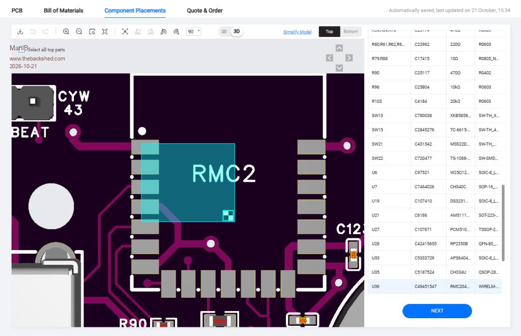

Hi Peter, hi everyone,
I'm planning another production run of the Pico Computer 3, with a minimum quantity of 15 boards.
I've noticed that your GitHub repository now contains versions 3.2 and 3.3 in addition to 3.1.
According to the README, V3.2 uses a different USB host power controller, while V3.3 also improves the thermal connection of the 1.3V regulator.
Before placing the order with JLCPCB, I'd like to ask:
Peter, would you recommend using V3.3 for a new production run? Has this revision already been built and tested successfully?
I'm planning to use the following files:
- PicoComputer3.3.zip
- PicoComputer3.3BOM.xlsx
- PicoComputer3.3CPL.xlsx
Thanks in advance!
Best regards,
Manfred
Added question: What's abot the placement of RMC2. It looks faulty.
Edited 2026-10-21 23:39 by ManiB
Posts: 12051
Posted: 02:04pm 21 Oct 2026
I've built 3.3 and it works perfectly, the keyboard version also uses the same circuit as 3.3. JLC don't have a 3d model for the RMC but the board will be fine.
